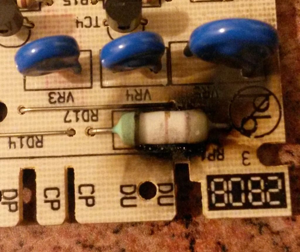

Ok so I removed the pcb to take a look, think I may have found a problem lol

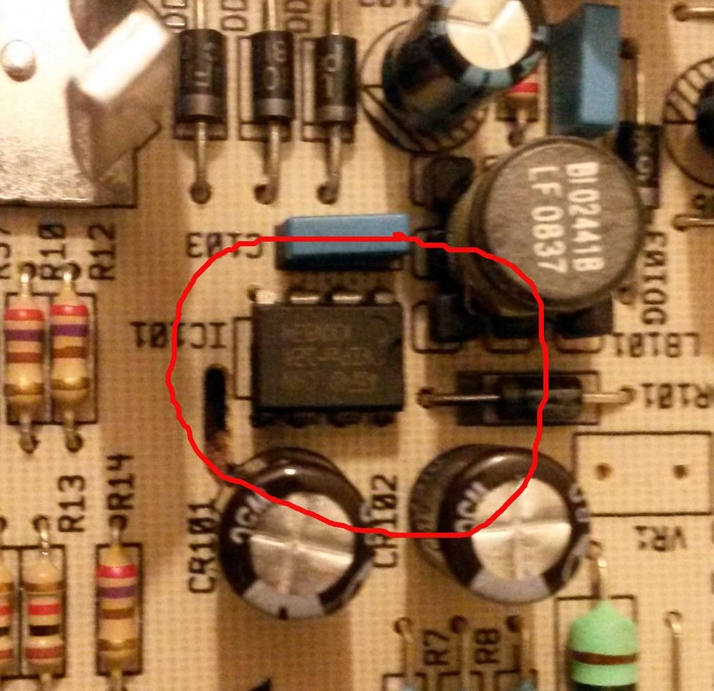

And also this chip was a bit sooty

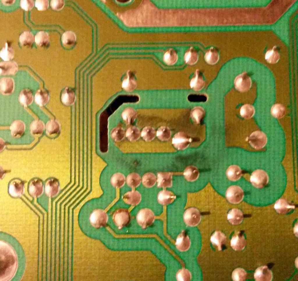

And on the back
That was after giving it a wipe,still a bit blackened though.
I looked up the board part number 41026074 and found plenty but it seems they need programmed, they just come blank for around the £40 mark.
But as the machine still does the spin cycle etc and the self test still works I think I'm going to buy a new chip and resistor and change them, see if that does the trick.

Those SMPS chips do fail sometimes, check it hasn't damaged the rectifier diodes supplying it. The resistor also acts as a fuse, make sure you replace with exactly the same resistor construction, as some resistor types will start a fire if the fault happens again.

I've decided just to buy the resistor first and see how that goes, do you think maybe the water valve solenoid thing just drew to much current and fried it?
I'm not an expert on these electronics by any means, just know how to use a soldering iron and can replace parts easy enough.
Ok for anyone finding this thread with the same sort of issue replacing that resistor has fixed my machine. I think the faulty water valve solenoid thing just drew to much current which fried the resistor.

Could prove useful for future readers what the rating of the resistor you replaced it with is? ohms and wattage
It is also worth noting that cleaning as much of that 'soot' of as much as possible is a very important step as it can be conductive and enable current to short across to other components.
Yeh I've come across a number of threads on various things where the answer was never posted!
The resistor was a 100ohm and 2 watt, brown black brown gold. I had to use google images to get the colour code as it was to far gone to read the colours.
