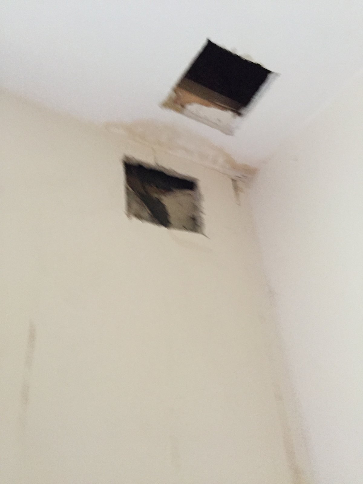

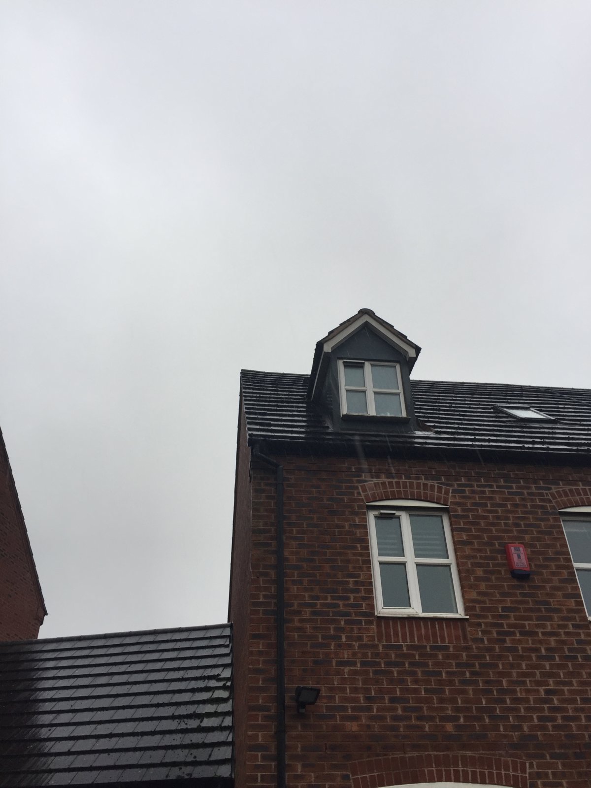

Hello,

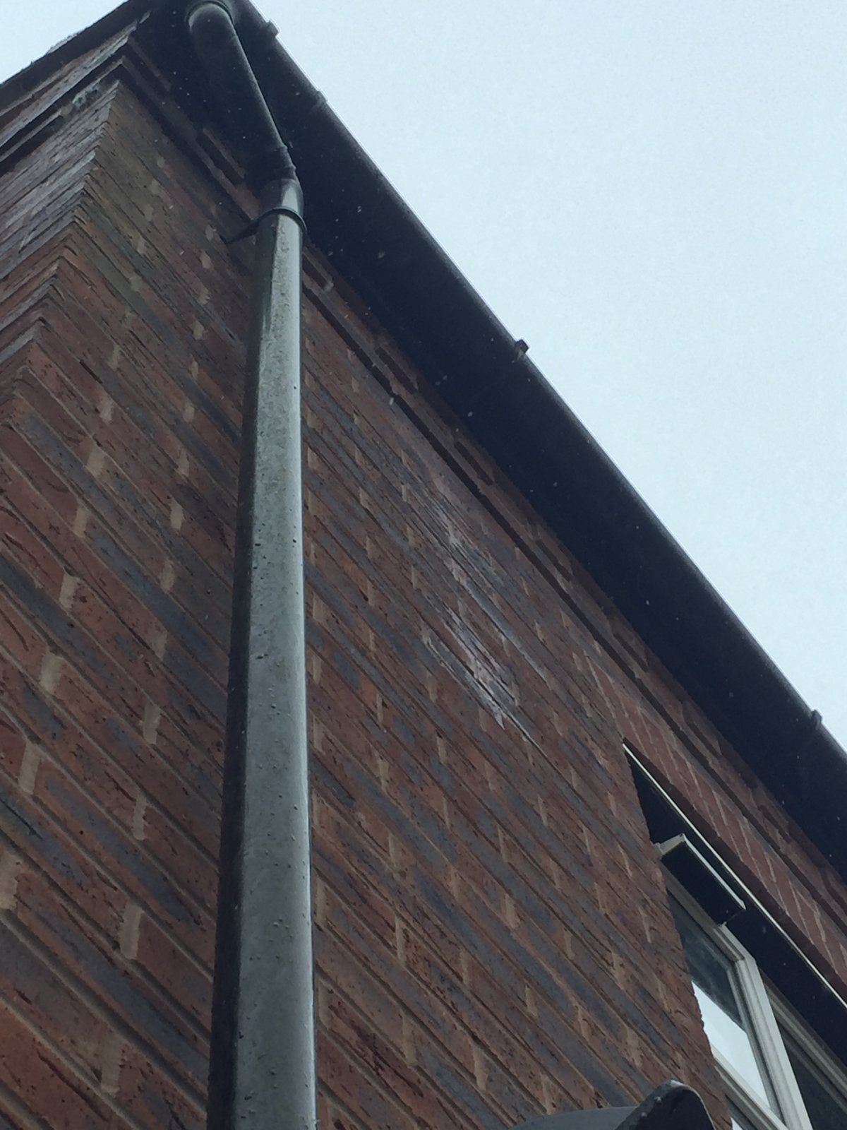

I have a leak somewhere in the roof and water ingress into the 2nd floor bedroom. I had a few roofers check and they said it was the felt rotted so had a layer of felt fitted up to first batten with epc trays all the way along the roof and also the valleys on both sides of the dorma remortarted. He said it would fix the problem but there is still water ingress on the corner of the room. Checking today in the rain I see a damp patch all the way down the outside wall and slow dripping coming from behind the gutter where it is fitted to the facia board. I checked the gutter is clear and not overflowing.
Any idea what it could be as I am at a total loss as to how the water is getting in.
Attaching some photos.
Thanks for your help.

i'd suspect your troubles lie in what and how the felt support trays have been fitted?
if you have access to your loft then crawl into that corner with a light/torch and have a look.
anyone else going on the roof should take photos of whats existing and what they claim to have done.
plastic Eaves Felt Support Trays are fitted and then the new strip of felt is lapped over them to slightly turn down over the gutter.
the roof tile is set with a projection of about 50mm.
moisture can be seen on the brickwork about 700mm from the corner.
doubtful but not impossible that the dormer valley is involved but that area can also be examined from below in the loft.
its difficult to see the main verge projection - it should be a min of 50mm.

Water should not be on the underlay... look to the dormer ..picture zoomed in might help

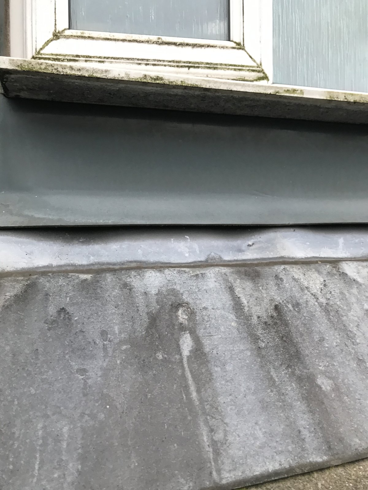

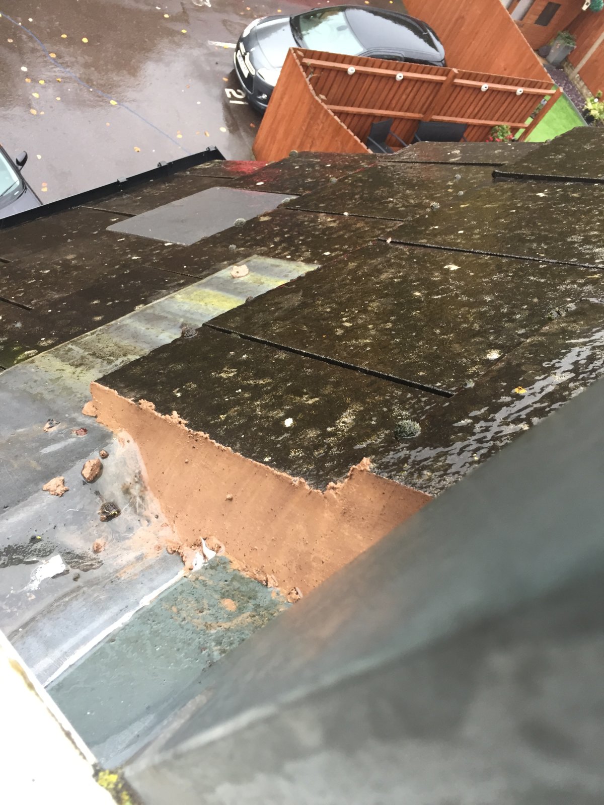

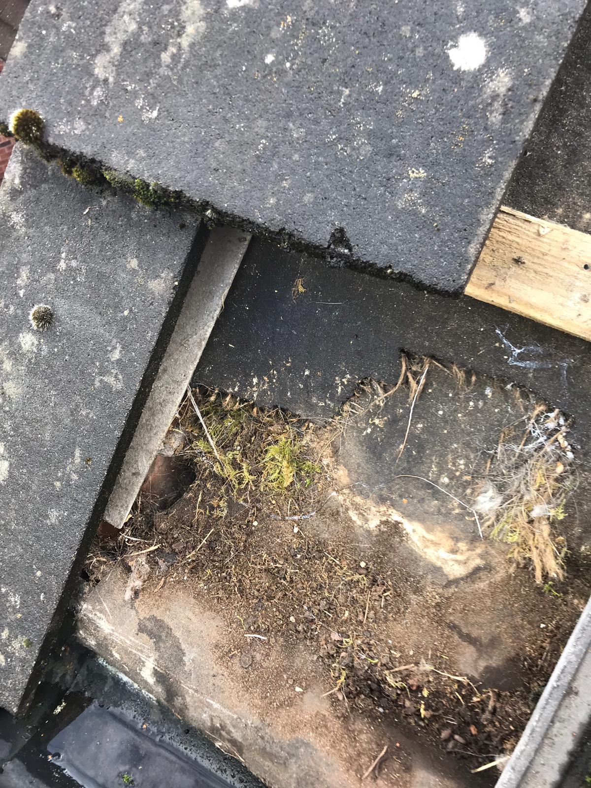

Hi bobasd and datarebal. Had the guy round again to check his work and he couldn’t find any issue where the felt and eps tray installed. He even checked the loft and didn’t see anything obvious. Attached a couple of more pictures. One of before the felt and tray fitted as well photo of the dormer from the bathroom window as well as from outside. Note that gap in the flashing has been filled in with silicone but I don’t have an after picture. Wondering if the issue is further up the roof and/or water getting through the brickwork through to cavity due to heavy driving rain as in the first picture attached the wall near the leak looks really damp. Having a couple of more roofers coming to diagnose later in the week. Really frustrating that cannot get to root cause of the issue.

the new pics show a roof thats got various "problems" that need a professional roofer's attention.
eg you show different types of material for the unusual dormer apron. the lead is a water trap.
eg the "mortar" (if that stuff actually is mortar) is simply a codge to somehow make up for a bad Dormer design.
eg an odd sort of filler piece for a tile.
eg the tile gauge looks a little short?
to my mind, the roof needs stripping and re-doing properly
