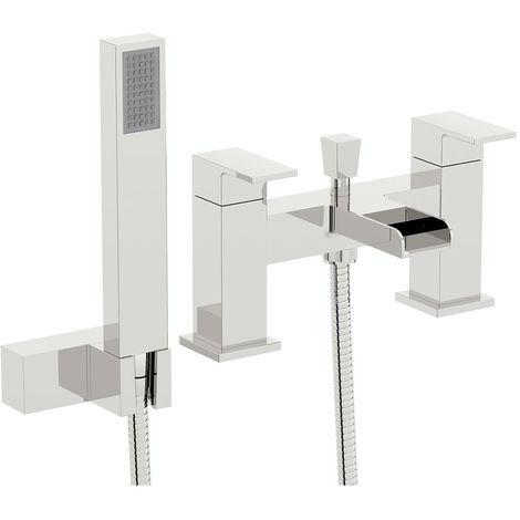

Guys, I'm trying to fix a really bad leaking waterfall mixer tap the same as the link below. I didn't even know taps had cartridges till I started reading threads on here, I've tightened everything else up I can so assuming I need 2x cartridges one for each tap. I've taken the grub out of the back of each tap and taken out the little screw with an Allen key. However I cannot get the tap head off to access the cartridge, it won't budge! Will there be more hidden screw's I'm not seeing? Hoping someone has fixed one of these style taps before! Thanks all!

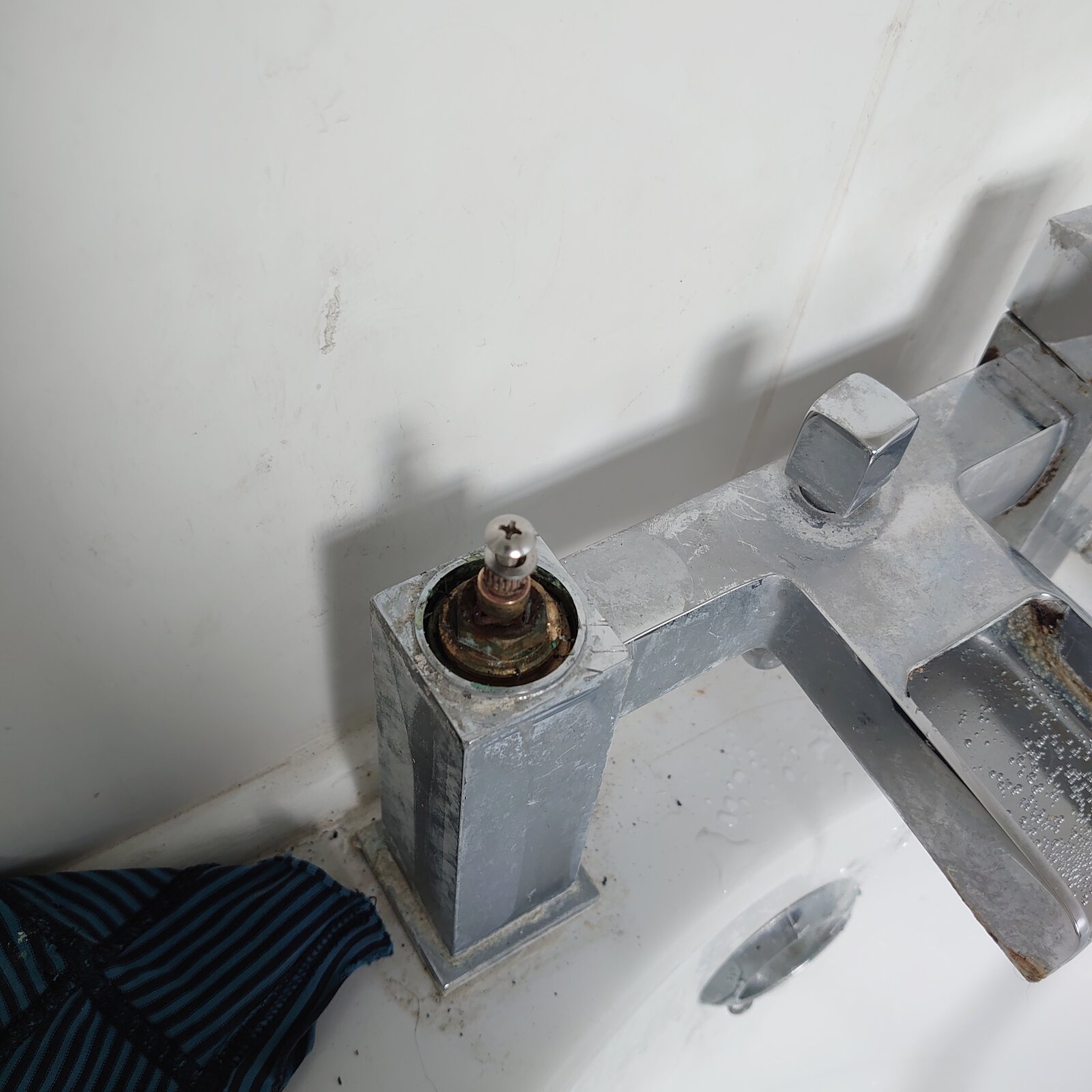

So that screw was in some rubber inside the tap, and I've stripped/ pulled off the rubber so the tap handle is useless now

Thanks for the pic ,can't work out how the tap handle unscrews from that. Still appears to be pulled up and off once the grub screw is removed.

Look inside the tap head itself, you will see a (white) plastic liner/adapter, it's that which is screwed to the valve.
The grub screw you took out holds the metal lever tight onto to the plastic adapter, and the screw holds the plastic adapter onto the valve and when the grub screw is removed then the lever should just pull up and off. That would then leave the plastic adapter with the screw at the top. You would then loosen the screw and the plastic adapter should then pull up and off the tap splines.
The inside of the lever has probably corroded and swollen onto the white plastic adapter, so would have been stuck solid.
