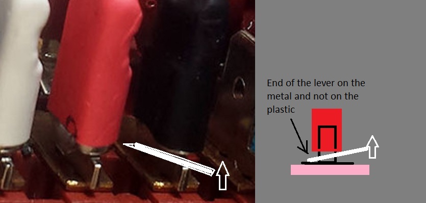

I've trawled the internet in an attempt to find anyone else with the same problem (and a solution) but it seems that I must be the first person in the world to encounter this. You can see from the image below where I've tried to use pliers to get a decent grip on the red (second from left) connector. Those terminals on the function selector switch are held in place by tiddly brass lugs. I've also tried getting flat-head screwdriver under the end of the connector to lever it off, without success.
Huh! Well, I discovered the solution: in my frustration, I ripped off the insulation around that red connector, and discovered a tiny lug thing that, when pushed, releases the clip thing that holds the connector in place! I never knew that existed. Problem solved (hopefully!).
Have you tried using a small lever to lift press the receptacle ( on the wire ) up wards and off the spade ( on the switch )
A small fork can be usefull as it puts a lever both sides of the spade thus lifting both sides of the receptacle to give an even straight lift.

Now you know where just use long nosed pliars to press and release the locking tab
Yep - long-nose pliers applied to that secret location meant the connectors came off easily. Is this something that is only taught in hushed tones in Electrician School and kept secret from Joe Public?!
