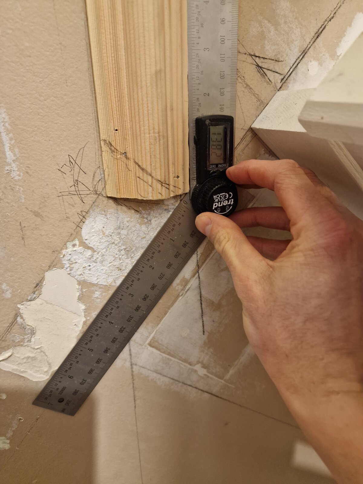

So the angle I put the dado rail on must be wrong as I tried a 70 degree cut earlier and it was a fair bit off. How can I find the angle with it currently on the wall? I have a trend digital angle finder.

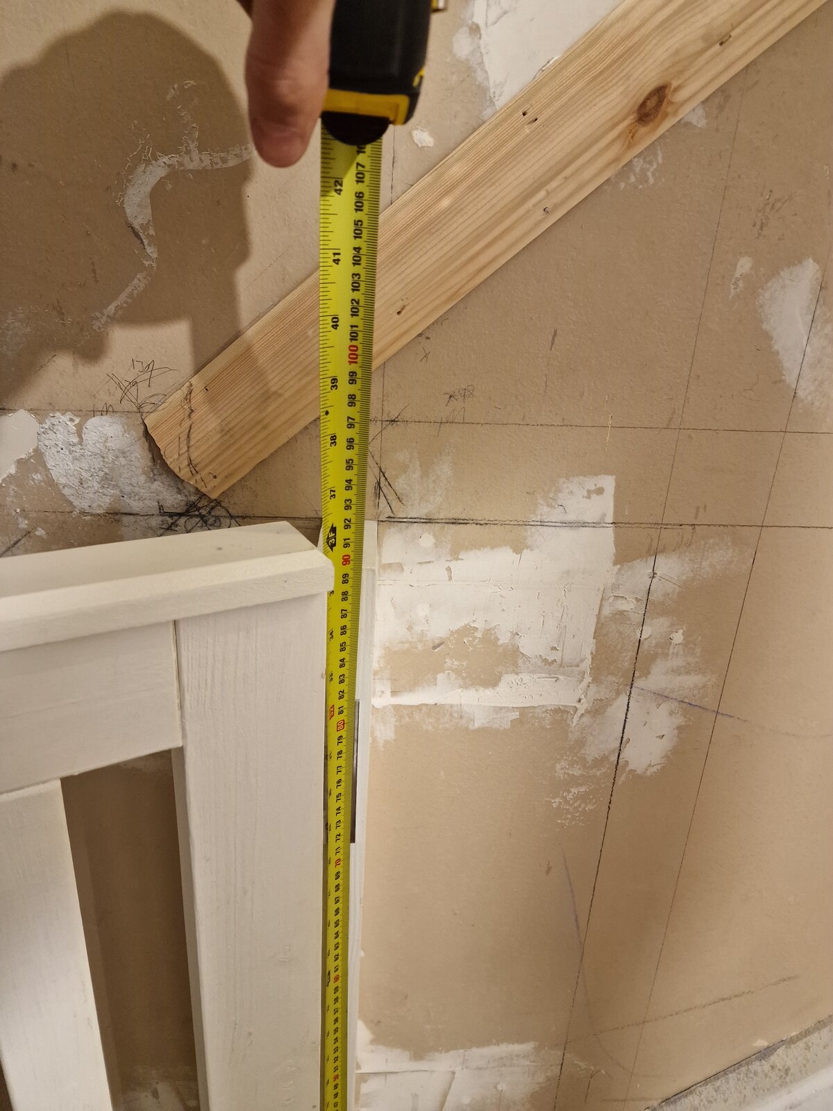

So I discovered which I didn't realise was the bottom of my rail is not 1m from top step I must of tried to leave room to cut away later.
It's a bit up the rail, so I cut this at 21 degrees and it was almost right but a gap at the top of the mitre. Tried 23 and 24 and having the same issue.
Do I need to take the dado rail off and start fresh tomorrow or leave it on and keep working on it?
This also leaves the rail higher on the stairs than the rest of my hallway which is 1m from my skirting board.

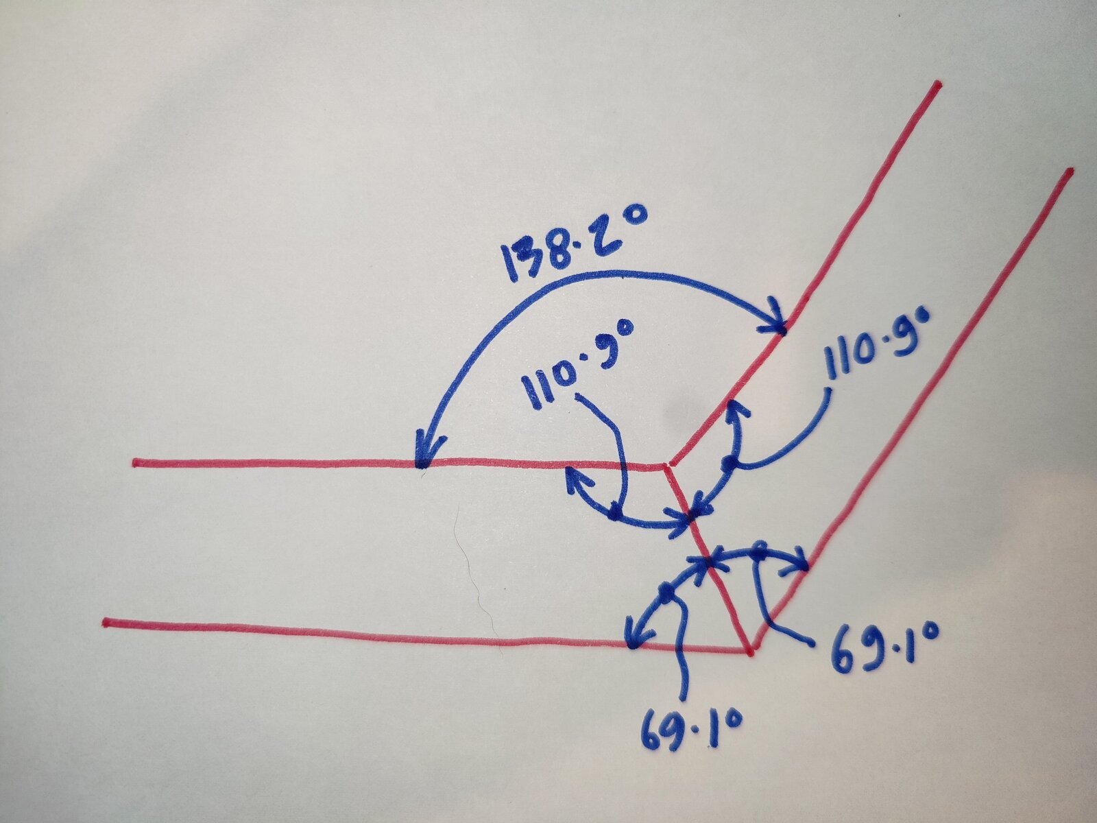

just remember both must be identical angle otherwise one cut face will be longer than the other
The way I did it, when I did mine, was to put the horizontal in place, then draw a line along top and bottom. Repeat the exercise, with the one intended to meet it, at an angle. The two pairs of lines will intersect, top and bottom, join those two points of interesection with another line, using a straight edge.
Cut the ends of your two pieces of dado, to perfectly match the angle of that last line you drew.

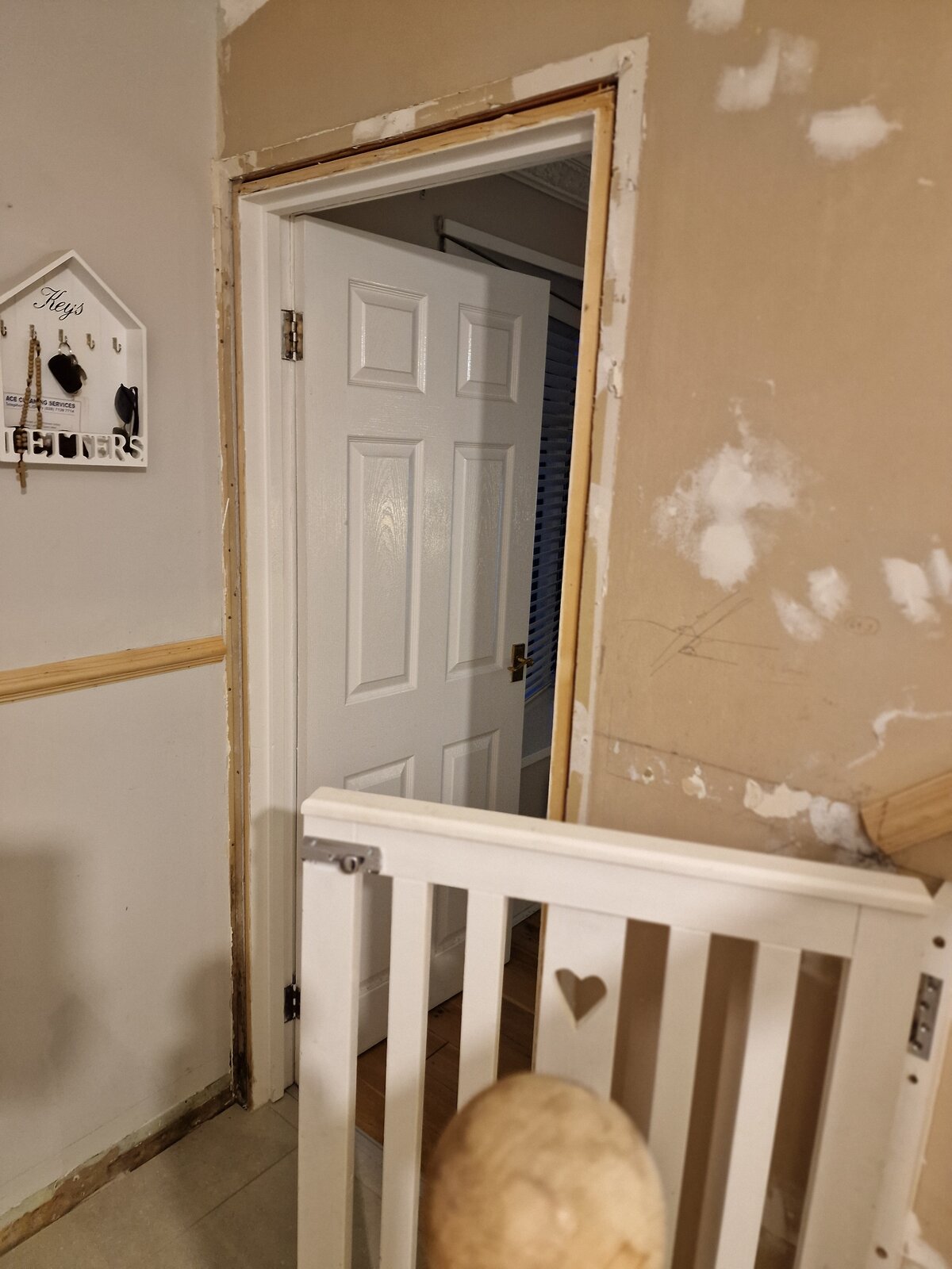

Can anyone offer advice in very simple terms where I measure to get my 1m line top and bottom and where i go from there?
Do I start with my horizontal and mitre it to the angle then go up or do I do my vertical portion up at the angle first with the mitre and make a piece to suit?
is there dado in the hallway top and or bottom and what height is that ??
Normally its from a line along the nose edge as the datum point but cosmetically what looks right with the dado in relation to other level off stairs sections
