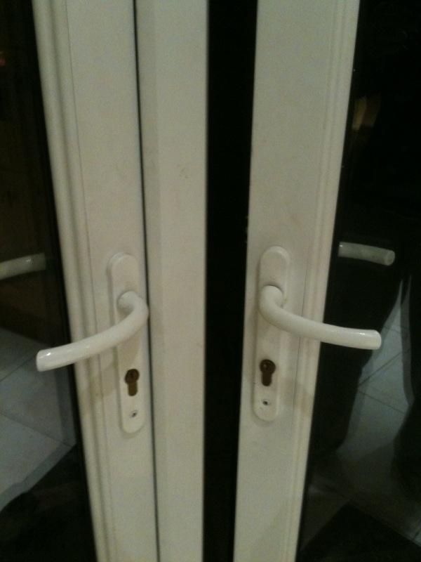

I'm in the process of upgrading the cylinders in my conservatory and kitchen to MUL-T-Locks as there have been a range burglaries in the area, and touch wood I have been okay so far but would rather be safe.
I can swap a Euro cylinder easily and have found the measurements however the problems lies in one door each of the double type opening outward UPVC doors I have.
The door are identical and both have handles and locks but one of them has an extra piece on it so that when the doors are shut one can lock into the other (I don't know what this piece is called, I've been googling all night with no joy).
I cant see how this piece that is fitted to one door and sits between the two when closed is attached and without removing it I cant get to the screw that holds the cylinder in place to replace it
Any clue please ?

The section that you mention is screwed to the door. Simply unscrew, and this will enable you to access the euro cylinder retaining screw.

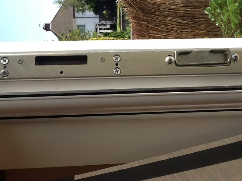

Pictures of the screws in this post, sorry for the inability to rotate, but do I remove ALL screws or just the ones on the left. The ones in on extreme right seem different, could it be just need to remove those?

What are you trying to do?
The picture is of the frame keeps. If you're trying to change the lock then you want to be looking at the door, not the frame.
My door looks exactly like the one above and the situation is the same. The picture I posted is of the side where all the screws you mention to remove are. Do I need to take these off the "frame keep" in order to get to the magic screw for the cylinder lock? Or only specific screws. There are quite a few screws hence the question.
You may need to remove the keep to reveal some more screws, there will be about 5 or 6 screwed through the plastic clashing bar, take the bar of to reveal the screw for the euro
As above you need to remove the screws that fix the jamb to the door, They maybe hidden behind the locking gear. When you find some that are approx 50-80mm long you will know you have the right ones.
It may also be fairly securely clipped to the door so you may have to use a flat screw driver to prise it away (slip it in from above).
Alternatively an easier way would be to work out where the screw would be. Use a tape measure and set square and work it out from the master door.
Then just drill a 8-10mm hole through the jam to allow access to the screw.
