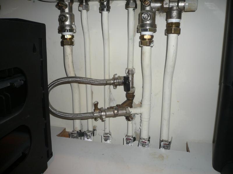

Ok, am doing my nut here.
Trying to locate the mains water supply so I can fit a new tap in the kitchen, but can't find it anywhere (under the sink the tap just has two pipes that descend and disappear into the wall)
I've got a combi boiler, which has six pipes that go in, one of them has a tap, does this (pic below) look like it might be the mains water supply?
Many thanks for any help![/img]

hi the mains stop cock has to be whithin your property, look in in all kitchen cupboards, hall cupboard, understairs , but it will be there somewhere good luck, best place to check to see if you have turned off supply is the kitchen tap as this will be full mains pressure
Those in the pic are isolator valves, the sort used for isolating the water feed to sink taps....
Sometimes the stopcock is in the bathroom or cloakroom - there's nearly sure to be one!
Failing that, it could be in the road or path, between the water meter and the property.
Perhaps you could ask a neighbour where their stopcock is?

Ah found it behind a fake skirting board in a cupboard, was like the da vinci code following all these pipes and valves - knew I'd either end up at the stop cock or in a secret lair inside the Vatican.... ;o)
Thanks for all your kind help!
Now just need to figure how the heck I'm gonna get these taps off, can barely reach under the sink to the nuts!
well thats an easy one you need to buy a Basin Spanner also known as a CrowsFoot Spanner available from all good DIY
Rich
then all you do is use spanner in a verticle position giving you more room and not smashing your knuckles so much :)
