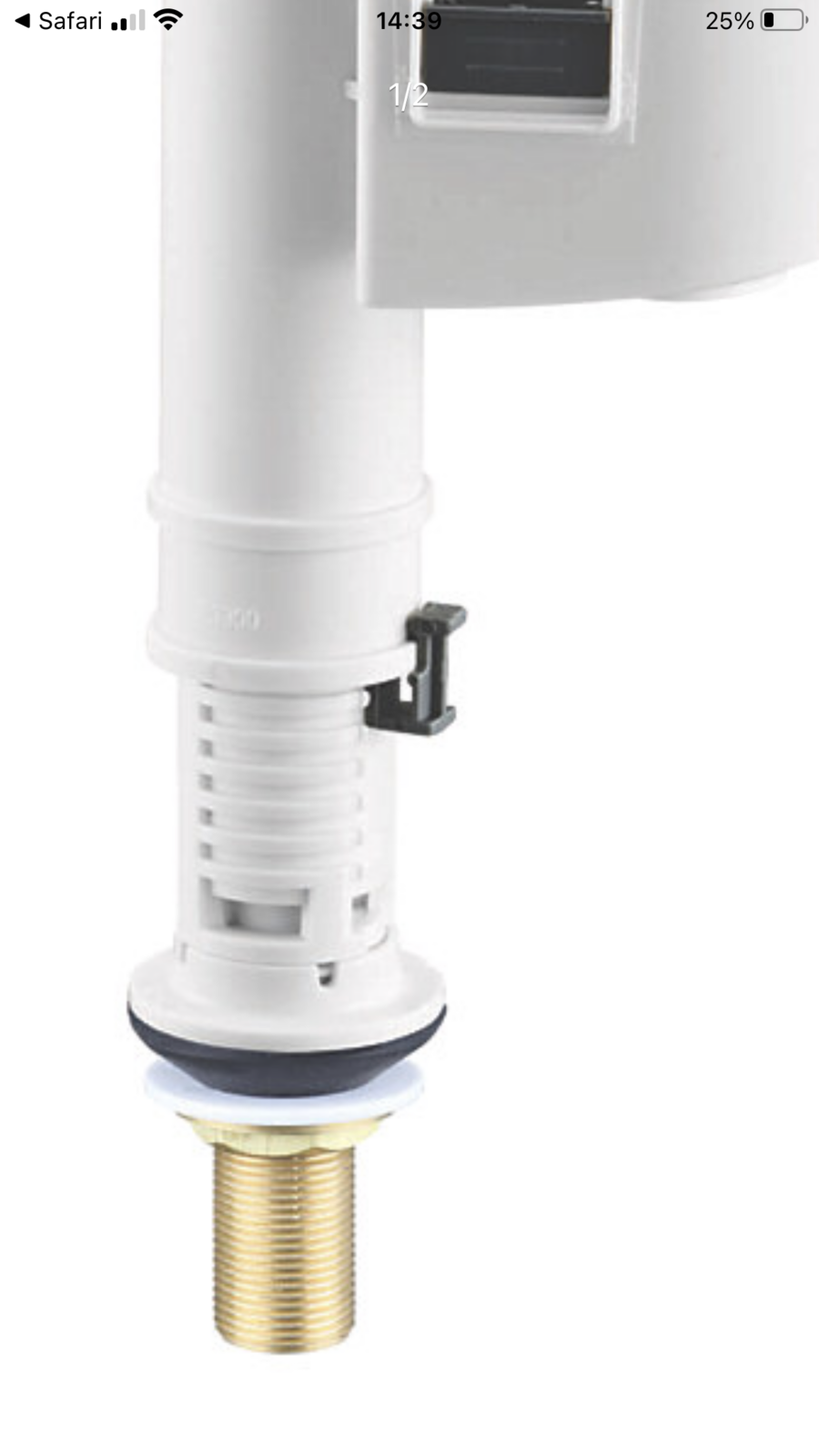

This is doing my head in.
Had a slight leak from the feed to the Fluidmaster fill valve. So just as i did around 8 years ago, popped it open & the fibre washer was shot. Replaced it & re-assembled but it won't seal. Pulled it apart & replaced the washer with an O-ring & that won't seal either. Pulled apart again with a fresh fibre washer & still leaks. Significant leaking past the thread, not just a weep.
Only thing that makes any kind of sense to me is that the plastic shank on the fill valve is somehow worn, but I can't see any nicks or other damage. Any suggestions before I bite the bullet & buy a replacement valve with a brass shank? That would be in hope rather than expectation.
The inlet connector has a collar for the washer to sit on & the washer should seal against the end of the shank.
1. Usual issue is that the connector nut has been cross-threaded onto the white plastic shank. Only realistic cure is inlet valve replacement.
2. Other possibilities:
2a. Remains of old fibre washer lodged in connector nut.
2b. Leak coming from cistern and only appears to be from connection. Resolution is to tighten white plastic nut holding valve into cistern.
get one of those soft tapered bung type seals.
if that fails then the cistern is cracked.

I've had the valve out to inspect the mating surface & the backnut came off smoothly, so definitely no cross-threading. Unless the brass nut is cross-threaded, which seems unlikely against a plastic shank.
No debris present.
Can actually see the water pushing up past the thread, that's just gravity fed so not even mains pressure.
Could try one of these if you dont want to replace the whole fill valve.

The leak is definitely past the thread & not from the cistern.
Just off to Toolstation for a new valve. :(

New valve with brass shank fitted & fingers crossed, it seems to have done the job.
