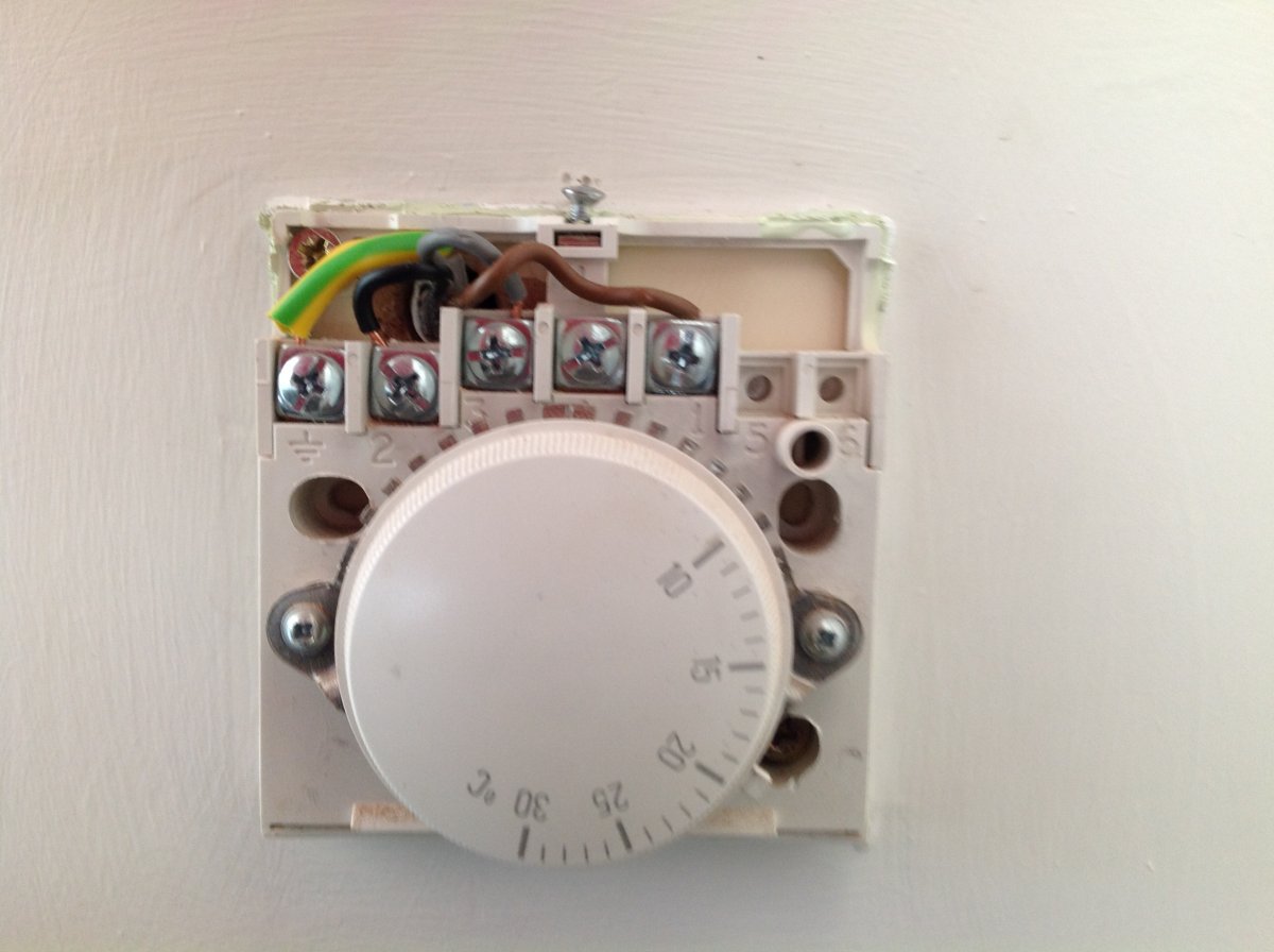

I have a new British Gas WR1 wireless thermostat to replace my Honeywell direct wired thermostat. It has 4 wires Black, Brown, Grey and Earth. Im really struggling to get it working. I have pictured the honeywell.
Which wires go where on the WR1 it has 6 terminals N, L, 1, 2, 3, 4 and no seperate earth terminal. Do i need to loop any together?
Your existing thermostat looks like a Honeywell T6360. If so the wires are:
Live = terminal 1 (Brown wire presently connected)
Switched Live = terminal 3 (Grey wire presently connected)
Neutral = terminal 2 (Black wire presently connected)

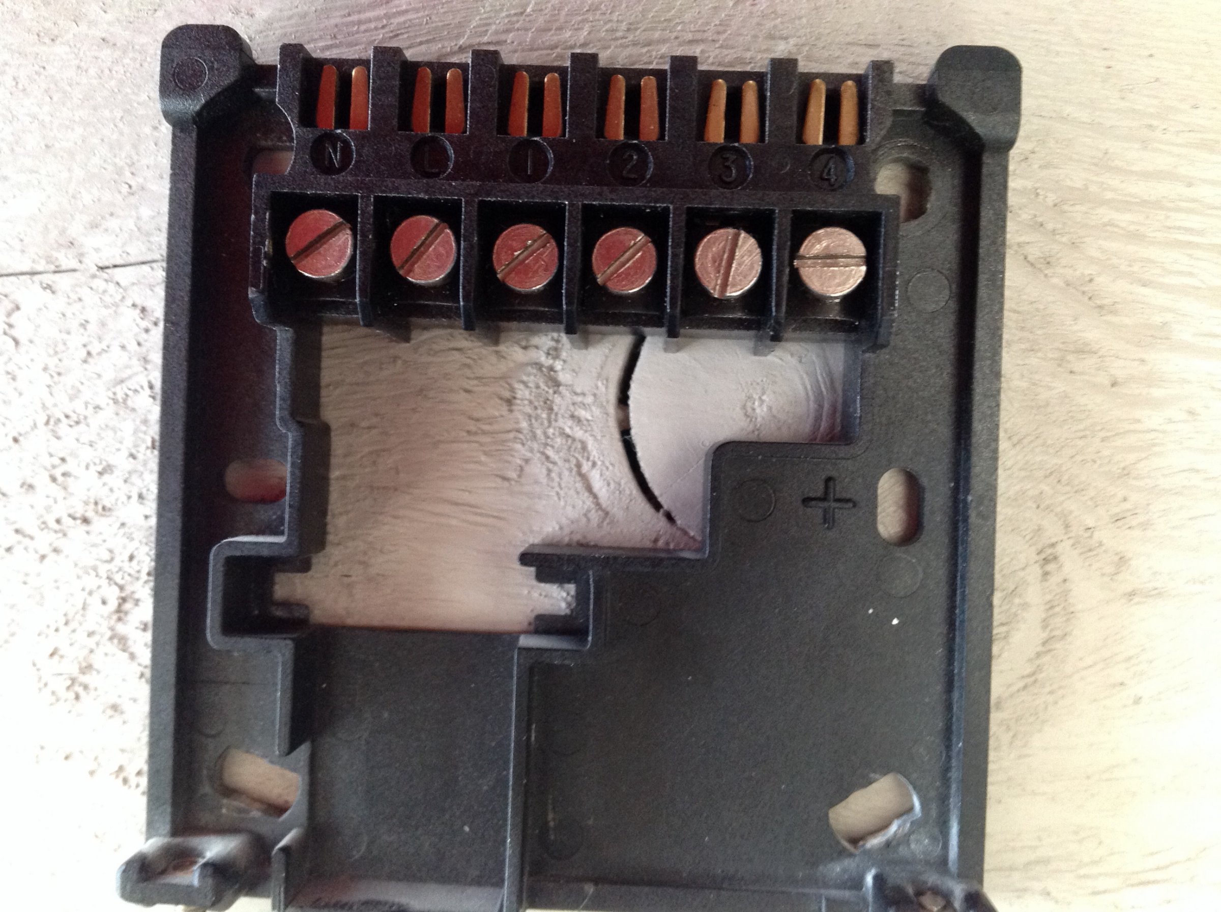

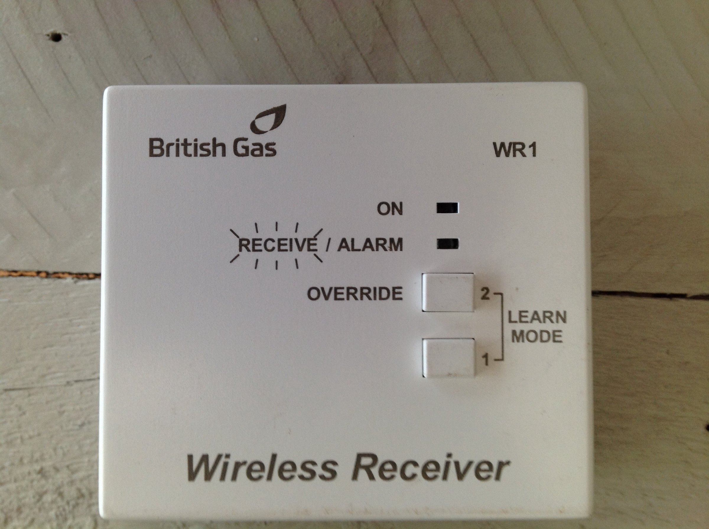

I think the no4 terminal is redundant as there are only 5 pins on the controller not 6 , I have attached photos of the unit and wiring
Perfect.
In that case N and L are self explanatory. (Black = N & Brown =L)
As you suspected, link terminal L to 1 (C or Common)
The remaining wire (grey) is terminal 3, call for heat.
