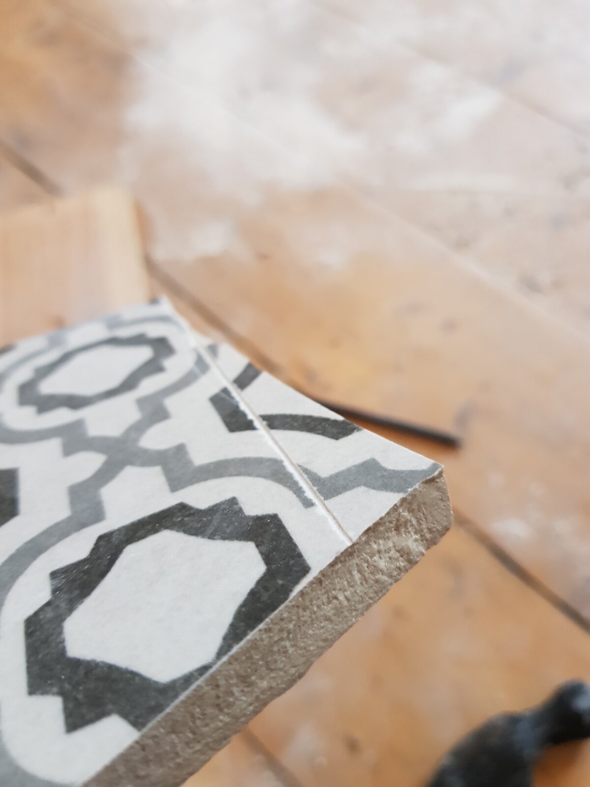

Hi, just doing my first tiling job. I have 5 tiles to cut in half for the end of the room. I tried scoring them with this little tool I got (photo attached) but then it's incredibly hard to snap and when I did it broke into many pieces
Is this tool wrong? It worked on my thinner wall tiles ok. Do I need to buy a tile cutter?
My adhesive is going off now, probably have another hour before it's ruined. So if I'm doing something wrong let me know
You need a tile snapper.
If your tiles are ceramic you can buy one from any diy store for £30.
Porcelain will require a better tool.
That scoring tool is only good for 100x100 biscuit tiles used in rented places.

If the adhesive is going off, take the tiles off and wash it off them until you can get the proper tools.

How do I know if they are ceramic, can you tell from the photo?

Buy a cheap angle grinder with a decent porcelain tile blade. That will be your best option as you will need it anyway to deal with the cuts around the doorway.

Are the tiles I photographed porcelain? I thought they were ceramic but I threw the box away!
They look like porcelain to me.

Can you get as nice an edge with the grinder as with a tile cutter?
Thanks for looking for me! I won't buy that cheap brand stuff, it breaks! But I think a grinder will be useful for other stuff, but I'll get a Makita or Bosch one. Will cost about £70 overall with tile blade.
I am no tiler, but if you have a steady hand, i cant see why not

for my 125mm dewalt grinder (125mm because thats the grinder I have) and disappointed cutting porcelain tiles, all the edges chipped , in my case it did not matter as ALL the edges are hidden.

BUT they suggested I should have used a wet cut for the porcelain tiles and thats an expensive
No chance, unfortunately.
It will chip like mad.
Can you go a bit over budget and rent a proper tile cutter?
Not too sure those tiles are porcelain, although they look like it from the pictures.
Can't you check online?
