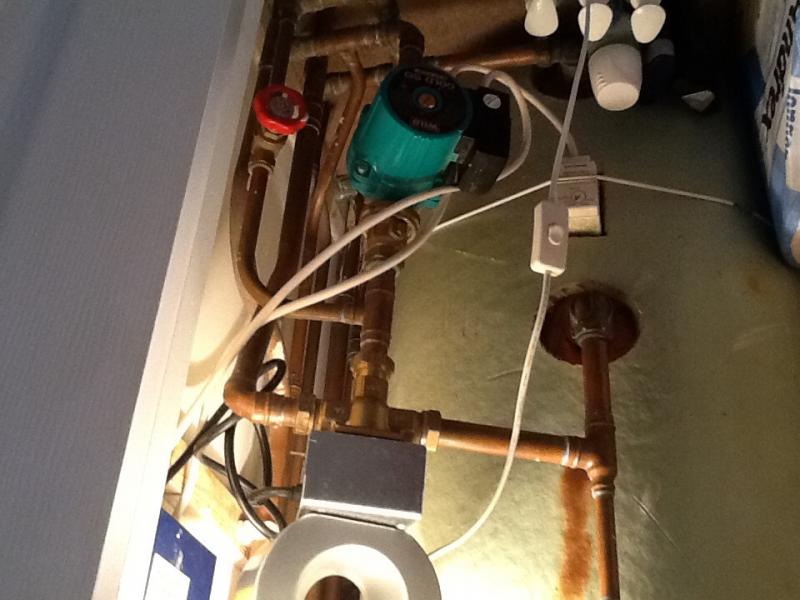

Hi
A few years ago I had a problem with a noisy central heating pump. Air was rushing through pretty much constantly, gushing and whooshing is the best way I can describe it. I called a local heating guy and he said that the pump is possibly pulling air down the header tank vent pipe. He the capped it off.
It always concerned me that he'd done that.
More to the point, it never did stop the problem.
I'd welcome any comments about the vent being capped off and any idea what the air problem is?
I do plan to put some Fernox F3 through to clean the system followed by some F2.
Many thanks in advance.

Odd. I've just loosened the compression cap off and water started to come out so I re-tightened it. On closer inspection the engineer has re-routed some pipe work!
He has connected the cold feed in to the vent pipe. What I thought was the vent pipe that was capped off, is actually the original cold feed.
So to clarify... There's no vent pipe at all. The cold feed goes into the cold feed and down to the pump?
Does this change things?
Thanks again for your time all of you
As long as it's in 22mm you should be okay. It makes it harder to vent a system but is usually better at keeping air out once you have vented it.

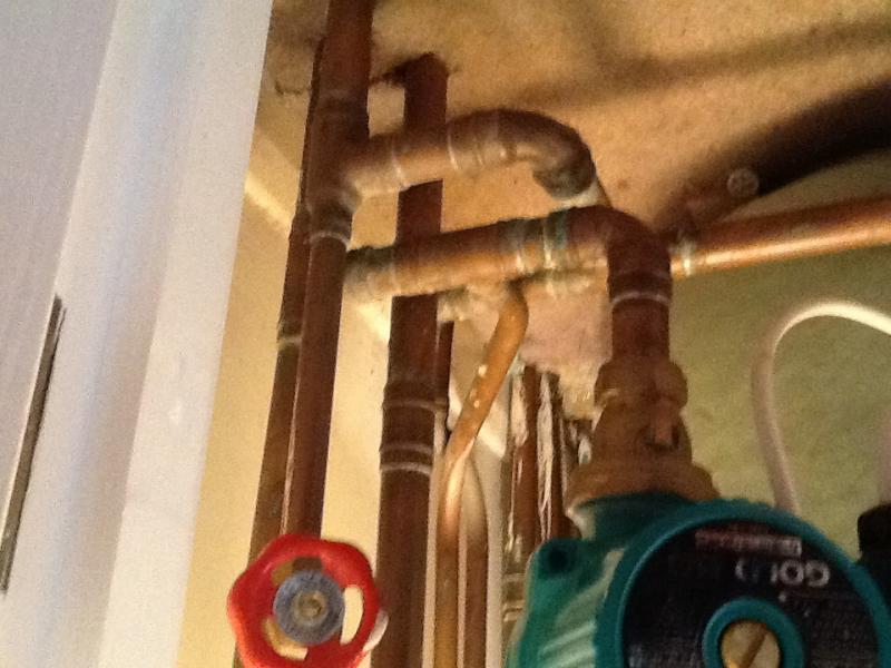

Here are two pics. The disconnected cold feed you can see joining the 22mm? Old vent pipe just before in goes into the bottom of the pump. So that 15mm that you see is redundant.
You have a magnetite build up that caused the pumping over. The pleb who sorted it hasn't got a brain and doesn't understand hydraulics.
Get a decent bloke in and he will sort it.
Listen to what he has to say and make your choice. If he doesn't seem sure try the next.
Jeff
The reason the problem was still there is because the cold feed is blocked.
The problem pipework needs removing and re-piping.
