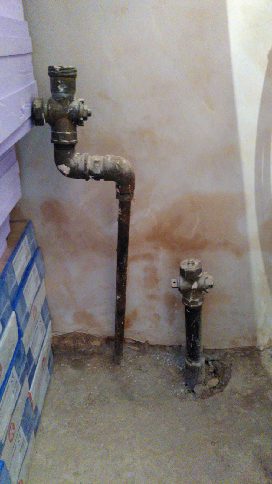

Can anyone ID these 2 pipes please. Not in use - gas or water?
I want to get rid of them, without flooding or blowing up the house.
Thanks in advance!
Both are old gas service supplies,best practice is to assume they are still live until they have been tested and proven to be dead
Ok great thanks both - will get the professionals in.
you dont say where in the country you are, Your transporter may be cadent, SGN or some others they all have different policies but worth giving them a call as some will come and test them FOC, I can only talk for Scotland not sure what other regions do , but if you say what county you are in and who is your transporter someone will know on here
