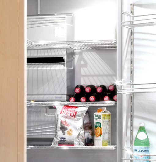

Anyone have any experience with a Carel easy thermostat for a fridge? http://alfaco.hu/file/CarelENG/PJEZ.pdf
I moved into a new house which has a corner fridge which is basically a corner cupboard with one of these thermostats and cooler.
It's recently risen in temperature and showing 9 on it. I found the above user manual which says to set the running temp, press set for 1 second then adjust the temp, and press set again for 1 sec. I pressed set for 1 sec, 5.0 appeared. I reduced to 4.0, pressed set but it still displays 9. Tried a few times and turning it off/on but no joy. The corner fridge company its from dont respond and an engineer wants £150 to come out. The thing is quite noisy so would replace it but it means replastering and new kitchen.

I dont know what the unit is called but below is a photo from the fridge companies website. One of their engineers called me. He said it's likely either the compressor has gone (circa £800) but I don't think is the case as it sounds like it's running. or needs gassing?
The engineer was somewhere up north and wanted £180 just for a call out. He suggested I find a local commercial refrigeration engineer.
