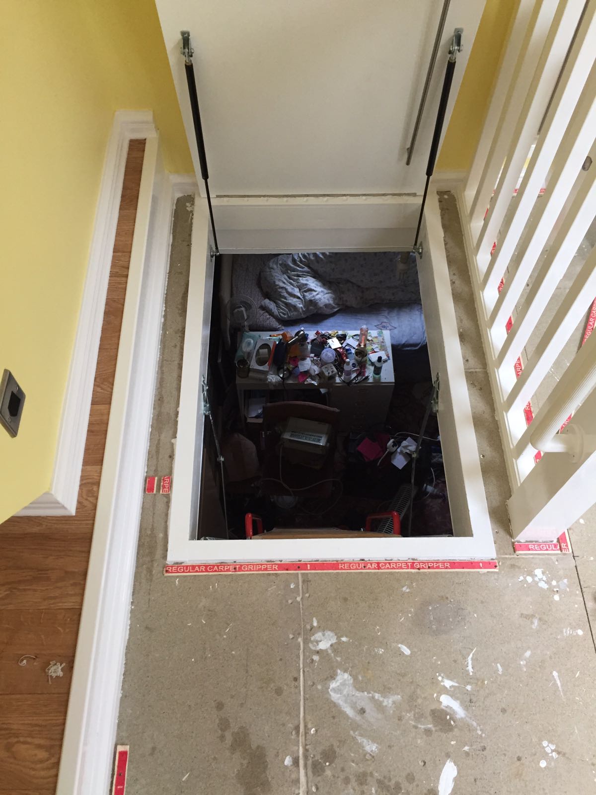

I'm tacking down carpet grippers in the loft room ahead of the carpet fitting day. I've done to rest of the room with no issue but wanted to consult you about the area next to the access hatch.
Next to the access hatch is 2 small areas which are to be carpeted along with the rest of the room. This area is about 8cm across so I don't know what the best practice would be. I have attached a picture to show what I mean. I don't know if it even makes sense to lay down two grippers opposite each other as the carpet stretcher may not work in such tiny places; I've laid down 2 bits of off-cuts on the left to show how tiny this gap would be.
Any suggestions on how to fit the grippers?
Or just infill the space with timber and paint white to match the rest of the woodwork.
I’ll still put grippers down there. What distance have you out grippers form the wall
If mean the area to be carpeted it's about 7-8cm across and 1.2m to the back.
I'm not looking to do this for a few reasons I'm not going to go into. Bottom line is that carpet is to be used as the infill.
Double sided tape
This probably won't work as there will be an underlay. Furthermore, I think the adhesive will deteriorate in the long term.
No I mean around all the edges. As your doing the grippers for the carpet fitter.
I've left a 7mm gap for the carpet to be tucked into after cutting. Yes, I'm doing this for the carpet fitter as they will be charging per metre. I'm simply not going to pay them for tacking down a few nails which I'm capable of doing myself.
