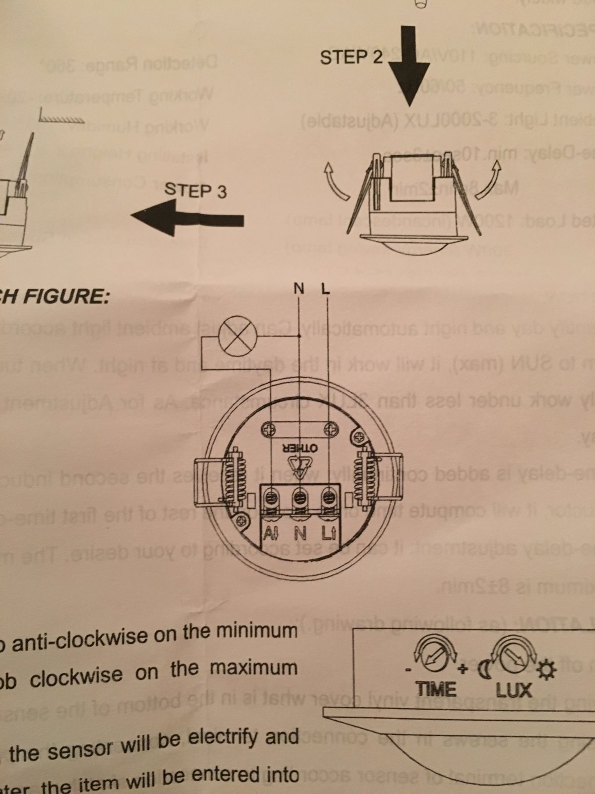

While it's all down I thought I would add a 360 degree PIR sensor to the lights so it turns on when someone/thing moves under the carport!
I have wired these in before but this wiring diagram is confusing me
It appears to me it used the neutral wire as a switch opposed to the normal switched live!
Am I reading this wrong or what?
Cheers.

The light is between the neutral, and the switched live (the LH one A I think)
So you think the left hand connection (yes it's an A) is the switched live? And the neutral is totally separate and should be wired as normal?
Every light requires a neutral and a live connection, but the picture they show is a representation of how things work. The Live has an in arrow, and the A an out arrow, so this tells you the direction the lives going. The light is shown across the switch live and the neutral, but the connection to the neutral is further back, so it's telling you that it needs the neutral connection, but that this could be further back on the feed, so you could use a 3 core cable, take it to the light, and then take it onto the PIR, but you'd only connect the yellow cable from the light to the A connector on the PIR. Alternatively, you'd take a live (connected to A) and neutral cable from the PIR to the light switch. Hope I've made it sensible enough for you, but if you've done these before I suspect you get the drift.
Ok I pretty sure I get the gist.
I have preinstalled a length of 4 core from the switch to the pir and back to the 1st light fitting of the daisy chain. I shall use the brown live to the pir and the grey as a live from the pir and wire up neutral as normal.
I'm confident that shall do the trick.
But did it go from the power, to the light, and then the pir, then you'd use 3 core, or from the power to the pir, and then to the light; in which case you'd only need twin and earth.
Power to Pir to light.
I think twin & earth would have done it but I had some 4 core knocking about so I used that!
