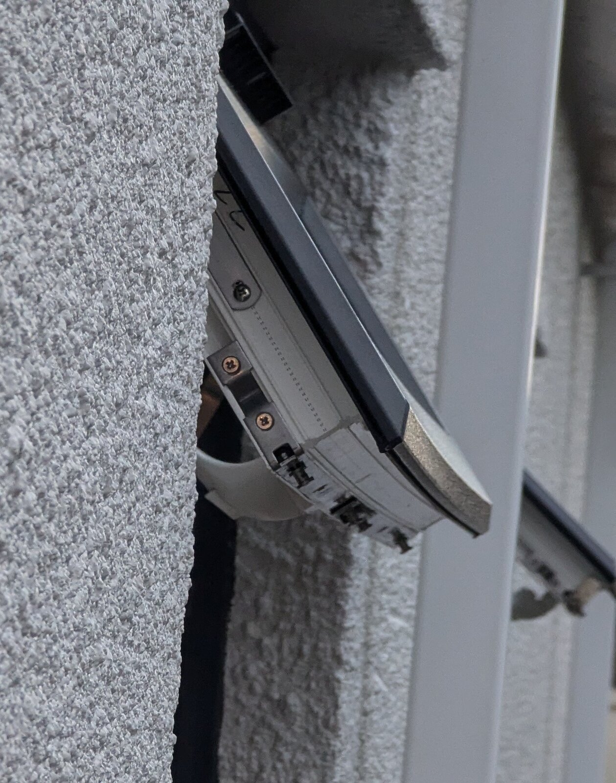

Hi
I just noticed that a casement which is approx 1m x 20cm is bowed in the middle.
This window was fitted last year, and we had the installer back due to a problem with the hinge.
How big of a deal is the casement being bowed, is it worth getting them back?
Grey on white, unfortunatley its quite common with foiled pvc especially the darker colours and exposed to the sun, if south facing then your fighting a losing battle
Oh wow, really? Didn't realise. Hardly fit for purpose if they can't take a bit of sun in the UK!
This window is actually a shaded area though, west facing but a driveway so never gets direct sunlight. Could this be caused by poor fitment? The installer had to fit bigger hinges iirc.
I would get it replaced, it'll probably keep going and become draughty.
Definitely nothing the installer has done here, I can see the hinge looks longer than it ordinarily would for a top opener that size but it's actually bowing in between the hinges

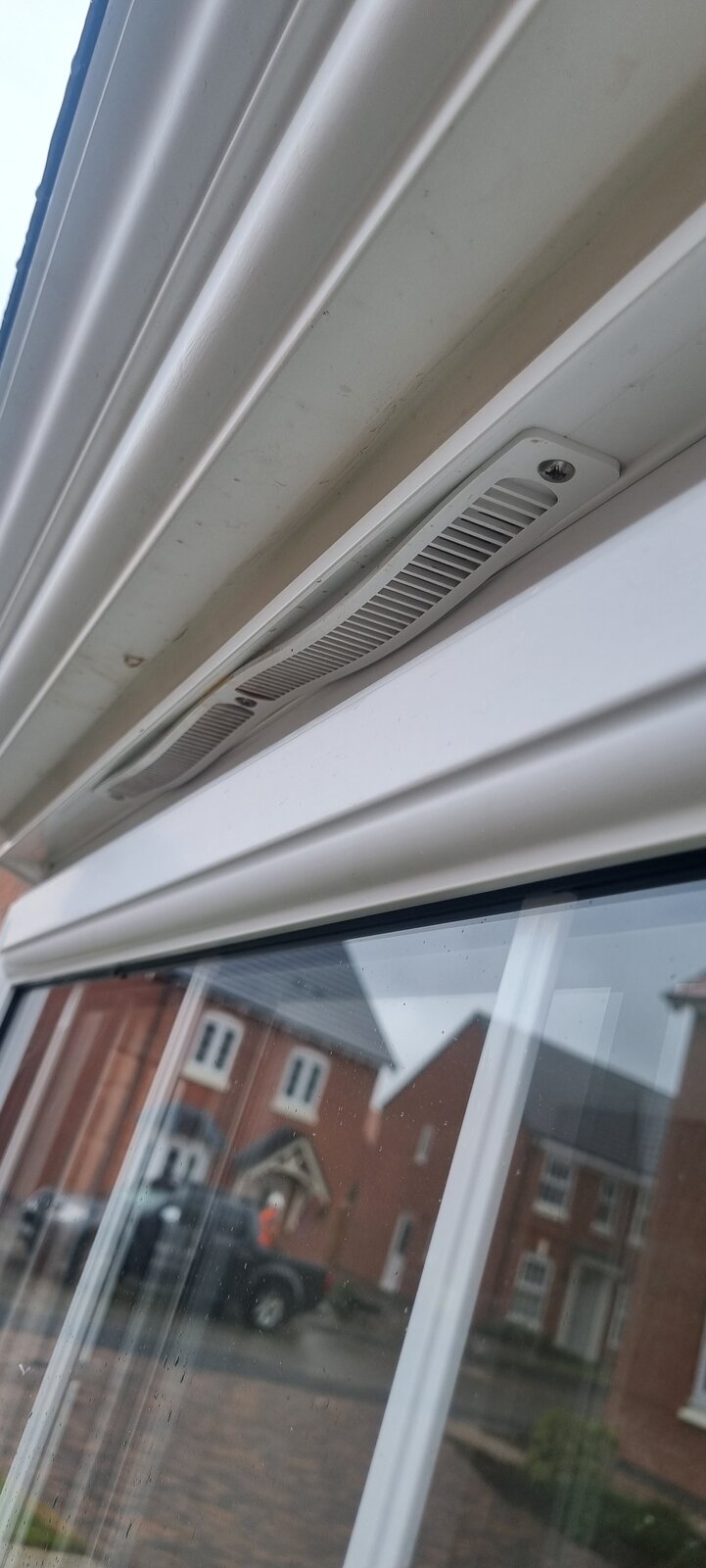

Just something I saw today whilst out snagging, not technically uPVC in terms of material but still a plastic that's already warped and it's a 3 month old new build, this would be easy to rectify by elongating the end holes to allow expansion
