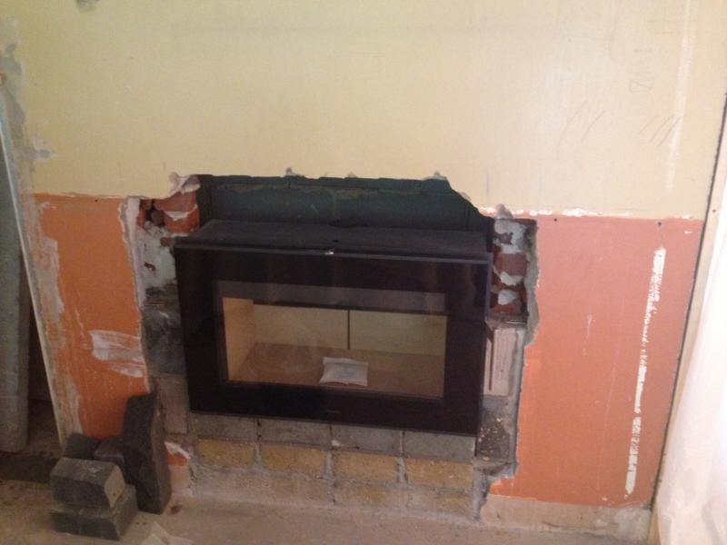

Hi folks, I seem to have a similar problem to yorkieboy (and I'm also in Norfolk).
We're refurbishing our ground floor and putting a Morso S80-90 inset woodburner into the existing fireplace. We will surround the stove with vermiculite and the fireplace will then be closed up around the woodburner using concrete blocks. This is all as specified by the woodburner centre who sold me the stove. Image attached shows where we've got to.
What I would like to achieve is the same appearance as the brochure, i.e. a contemporary look where the woodburner looks a bit like a wall hung tv.
The stove sits inside an insert which has a front flange designed to sit flush with the wall (according to the instructions). The fitter though has other ideas and says that the plaster will all crack and fall off if we don't put tiles or slate or something else behind and around the flange. This will change the clean lines of the stove.
So I am thinking we should chipp back the existing render around the fireplace and re-render with 6:1:1 lime mix, then use Vitcas plaster. However again the fitter simply says he's seen this done before and it all fell off.
Can anyone offer some guidance?
