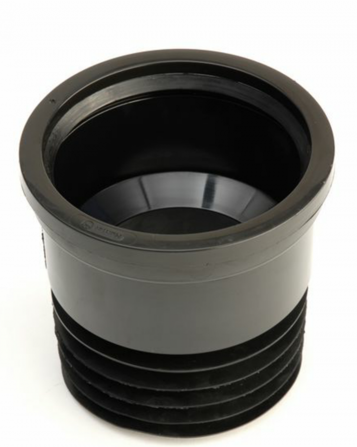

However you can buy a cast to plastic adaptor, try drain centre, they will have what you need, but measure the cast stack first.

The fitting i have used in the past fits internally inside the cast, then has a socket on the otger end, so u will need a small length of plastic pipe for the air admittance to fit on to.
I don't understand why 2 135Deg bends and a bit of pipe couldn't have been used and run it up over the gutter level as usual? Jeesh, they could even have just used a fernco to connect it. Do remember that an external AAV should really be inspected annually.
