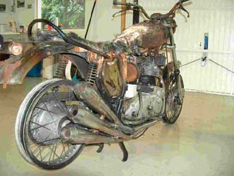

I want to "cast" a petrol tank in something solid enough to hit.
I'm not too worried about the finish as it will have a covering.
The bottom of the tank is flat, it's the curve of the top and back to front taper that I want to capture.
I have a tank (second hand) that is too big and want to cut the bottom off, fit it over the casting, and hit it so that it deforms to the shape. It's aluminium so should shape reasonably. Once it fits, I can get the bottom welded back
If I can't hit it on the concrete, at least I can fit/remove/bash/refit and so on

It's a triumph hurricane replica. I have the fibreglass, and a trials aluminium tank that's part way there.
It needs to fit inside the f-g
Normally timber bucks are made but for a one off (maybe a few) it's quicker to use something I can cast
I am doing this very low tech. You can dish aluminium by using a tree trunk with a depression cut into it. If you cut the hole "avocado" shaped, you can vary the curves.
Inside the fibreglass unit

I have the fibreglass unit, but not the aluminium tank.
I have a similar tank, but it's wrong in a number of places.
So I need to reshape it.
To make the cast, I was going to press the fibreglass into something that would leave an impression.
Then I can add something that will allow for the thickness of the material (3-4mm)
I'm trying to this at home but if I can get back to work soon I have access to all sorts of sculpting tools and materials.
Another option is to scrap the aluminium idea and make the whole thing out of Ethanol safe fibreglass but that's not easy either and aluminium is my favourite.
This is a bike that was in a fire. Trying to replicate the tank that you see. The cover (melted) is what I have.
I have the "shoe", I'm trying to make the "foot"
