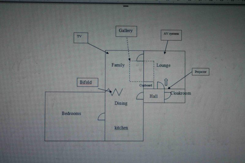

Sorry Ive taken time to come back. 50 tonnes of earth and screed got in the way.
Hope the drawing makes things clearer. The family room, lounge,hall are the extension and are vaulted left to right, up to the roof. Bear in mind its a bungalow.
The cupboard which is central is where I want to place any hub/s. I have two sets of IMF speakers and an ipod. The rest I have yet to aquire hence the hesitation and need to be flexible.
Those HDMI over IP senders look great, I didn't even know you could get them (have only ever seen baluns before).
I don't think I would buy the current crop though - video compression artifacts and lossy audio kinda defeat the object of buying bluray, so I would go for baluns and lose out on some of the "but it's over IP!" points.
I am probably complicating things but as BD video is only 40-ish mbps I would build a MyMovies server, rip all my BDs to that and put a small HTPC by each screen. For now it's expensive and hard to do proper TrueHD and DTS-MA from PCs but it's sure to become more viable soon.
