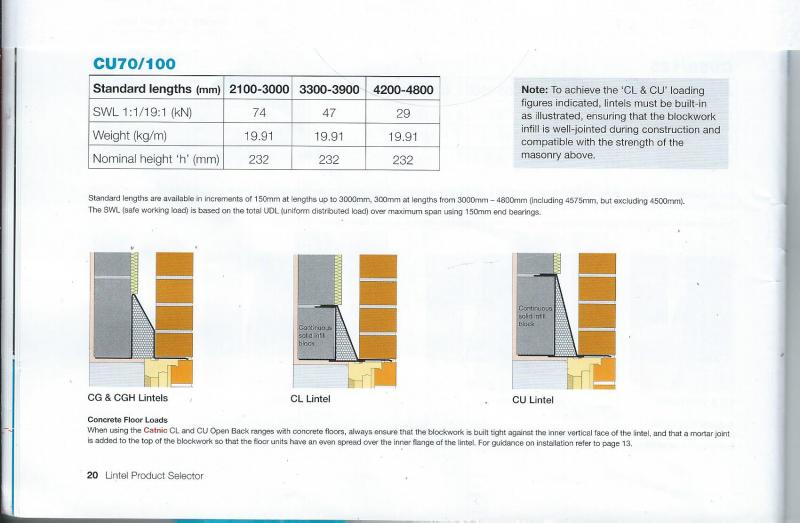

Here's an extract from a Catnic brochure.
For this specific lintel, it quotes reduced loads for longer spans. So if using this particular lintel, OP would have to work out the loads (or get Catnic to advise).
Point being that somewhere along the line, some calcs would need to be done.

Takes about two mins to work out the loads Woody.
As Tony has said, lintel manufacturers give a safe working load for a given lintel length. You work out the load and choose the correct lintel from the tables for the calculated load.
They haven't done all the working out for you...
Just because BCO doesn't ask for calcs it doesn't absolve you of your professional responsibility to ensure you provide the the correct structural elements.
