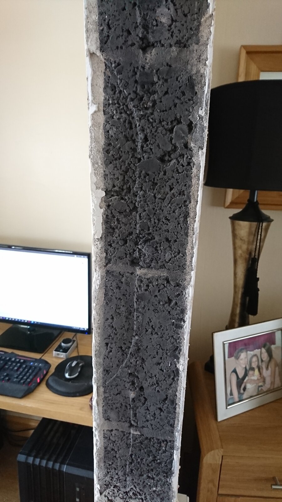

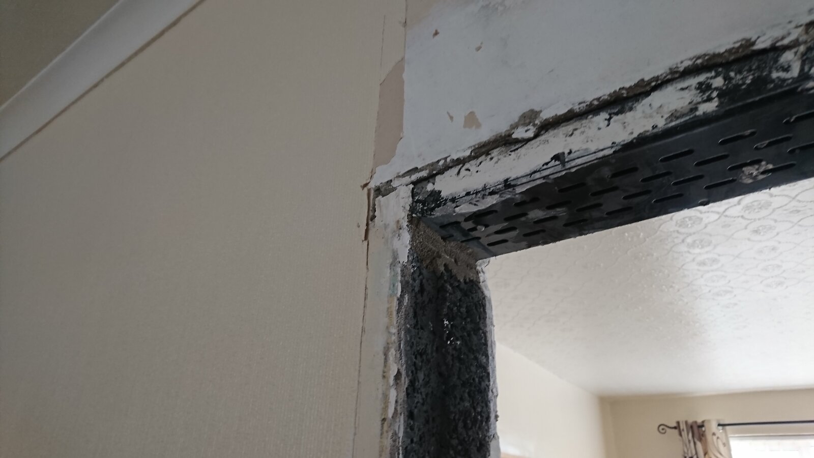

I have ripped the coverings of what has been done and to show a pic of bricks wall is made of and box lintel used. So are you saying with an loading point width either side of 185mm is suffice.?

With a max. reaction of 19kn (unfactored?) bearing stress would be 19x1000/250 x 100 = 0.76N/mm2, so agreed he wouldn't need padstones.
Thank you very much for your assistance, am a new user and very impressed with fast response here.
Yes as stated even using standard 150 bearing length, 19.5 x 1000 /150 x100 = 1.3N/mm2
