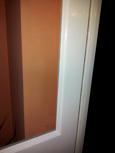

Just means you are not very pro. I did it for years. Here's one done a couple of years ago. Grey is the interior side silicone - it has water paint on it indicated by the intermittent white edge. The exterior silicone bead has 10 year oil gloss on it. If I get a £ every time I catch you out, I'd be a rich man.

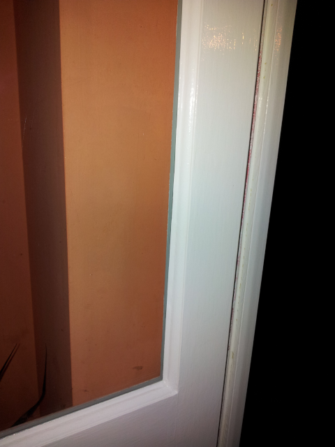

The first four links I found when google searching for "paint over silicone sealant" - 2 links from sealant manufacturers, one from a paint manufacturer and one from a company that specialises in applying sealants. Funnily enough, each one of them disagrees with you. Why would that be?
Over the years, there have been times that I had to force paint over silicone. I can be done, you let the paint start to thicken, then force feed it more coats. The paint is not adhering to the surface though, it is simply skinning over the silicone. If you run your fingernail over it, it will crack off.
I have no idea if the grey sealant in your image is silicone, MS polymer or polyurethane. I suspect that you don't know either. If you apply water based paints directly over silicone, you will witness the formation of fisheyes as the silicone repels the waterbased paint.
You really are out of your depth here (again). I do not understand why you are a member of a forum that has DIYers asking tradesmen for advice when you seem to believe that all tradesmen are charlatans.
