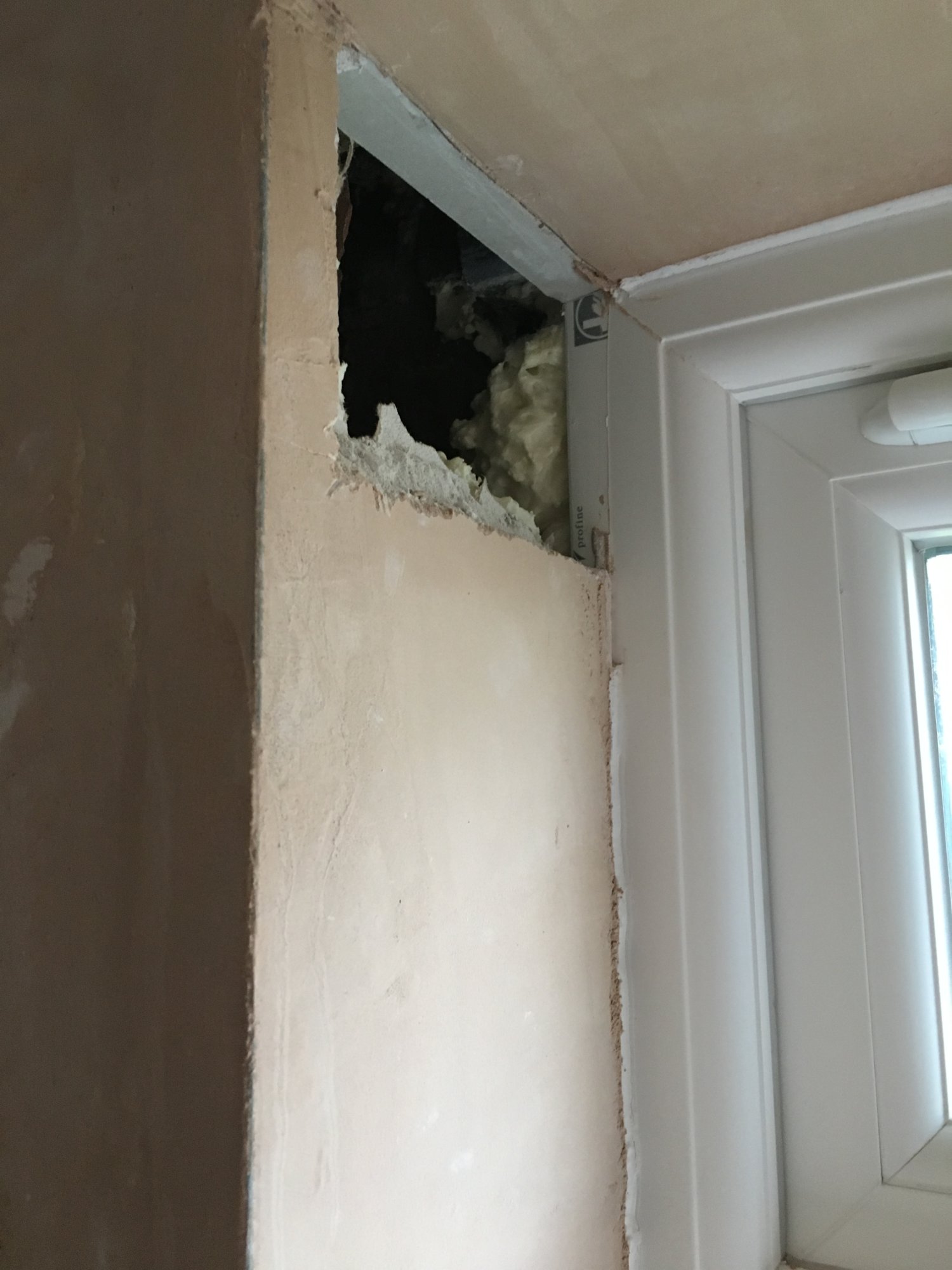

If it's an insulated cavity lintel then the top will be ok, but not if it's 2 separate ones on each skin . The cavity closers would normally be sides and bottom. Who plasterboarded it? Cant you cut a test hole in the reveal and see what's behind it in the cavity?
A window company would not normally fit a window across a cavity, but would fit it forward into the outer leaf brickwork.
So you could have a look, and make a hole.
Required bottom and sides. It would depend how the firm has made the window opening as to whether (if needed) you could fit closers or just some expanding foam and DPC.

The lintels are two separate ones (concrete on outer).
Yes, a test hole is a good idea. Skimming wasn't the best and I was going to reskim when doing the main wall

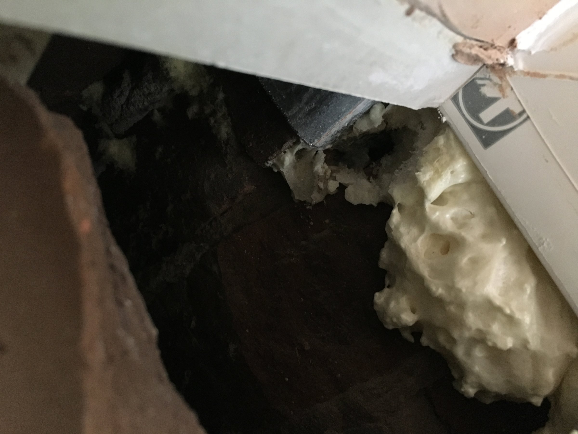

Ok, cut away some of the plasterboard to see what's behind.
Steel lintel on outer skin, looks an L section.
Looks to have about 5cm length overlap to brickwork, but not sat direct on brick, prob 10mm gap and had been filled with expanding foam only. Dug away a bit just under lintel to see if any slate had been used to pack.
Nothing closing cavity and expanding foam used to D&D the plasterboard to sides.
Separate piece of timber used for lintel on inner brick skin, seems pretty thick.

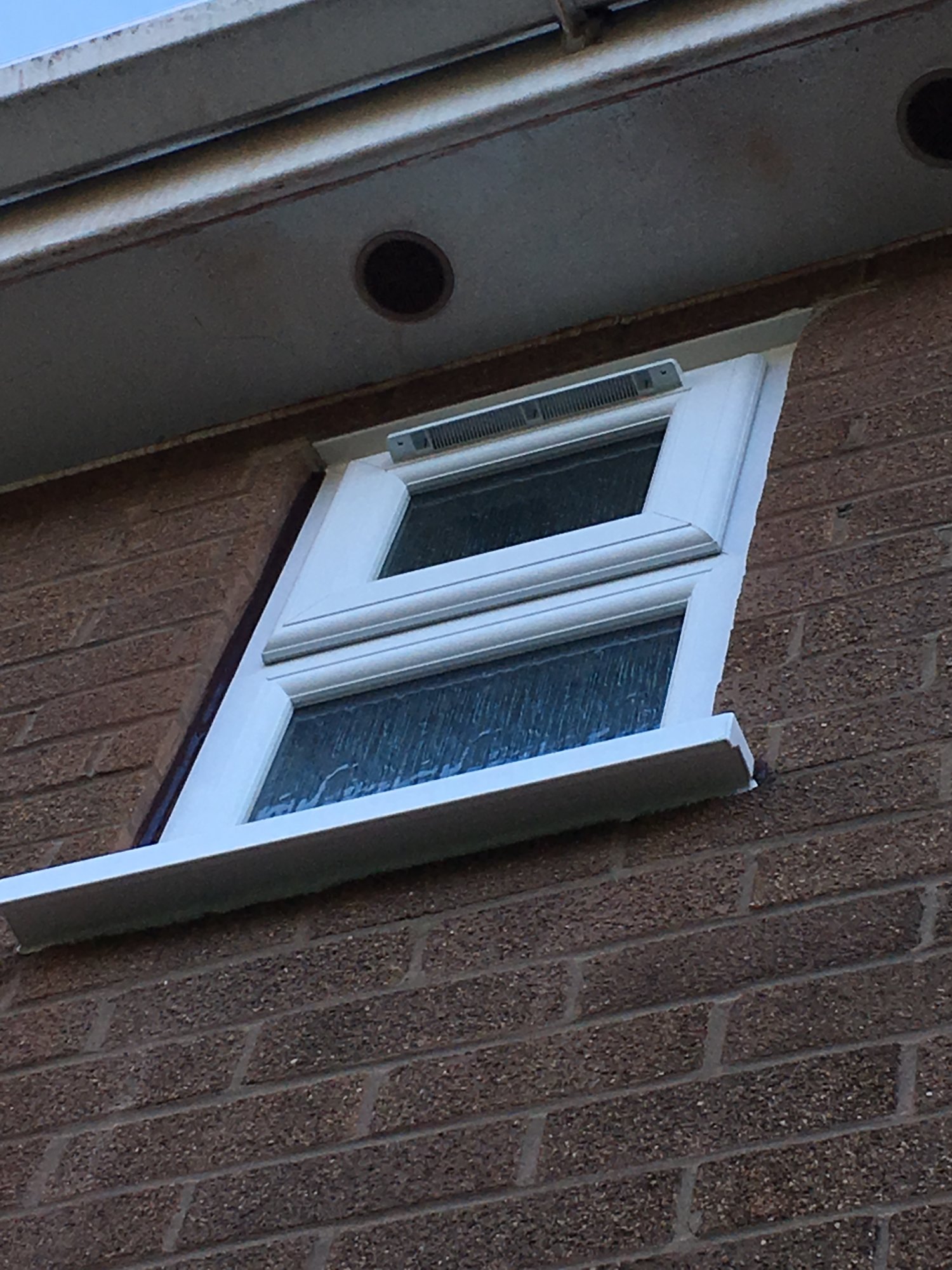

From the outside
I know when he started, he said it was only a small window (42cm wide) and with only a couple of brick courses above wasn't much weight and didn't need a lintel, after talking to his builder. But he'd quoted for it and as it was a new opening and outside wall, I was happier with something there so he did it.
Would be interested in views on a lintel here - is the window below a minimum width for needing one?
I'm aware steels in big openings are normally on pad stones with 150mm minimum overlap, but surely that would be overkill for a little window?
He was aware that LABC would be involved before quoting/starting, so I hoped this would help.
I need to decide what's needed from here. I'm hoping there's some remedial work that I can get him back for, that doesn't involve taking out the window and start over, redoing lintel too.
