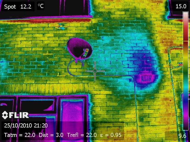

I did the same with my house and blocked them off. I cut a piece of clear perspex to size and used clear silicon to hold it in place.
Here is a thermal image from outside showing the cool air circulating in the cavity

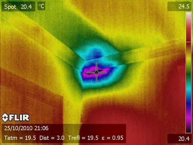

here is the result of the cool air on the inside wall
If you want to block air bricks up, just use clear silicone - which can be removed if you subsequently find out it was a mistake.
