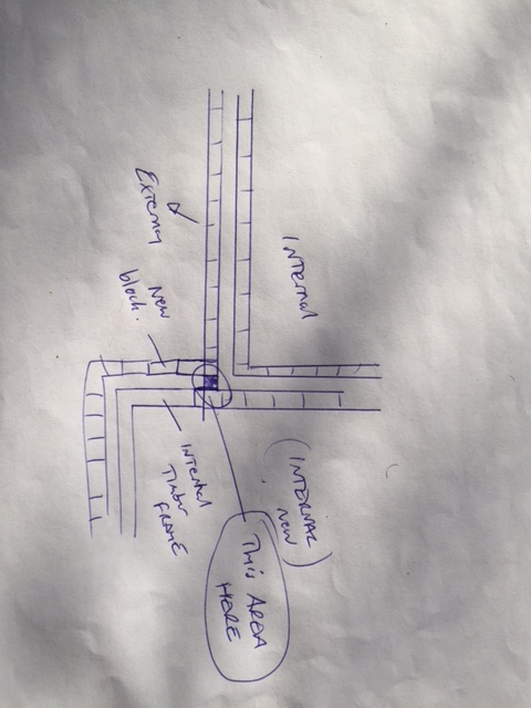

Morning All,
What is the preferred method of joining walls at the corner of a house. I will be attaching an internal timber frame with external blockwork (rendered).
Do I:
A/ remove a 50mm run of external existing cavity wall to blend with new cavity.
or
B/ just cut a run with an angle grinder right through and slip in a DPC?
or
c/ do nothing and leave the bridge
Ive attached a quick sketch below to illustrate.
Thanks.
Cut out a slot in line with the back edge of the new external wall. Wedge a strip of DPC in, no need to point it up, just a bit of silicone or tube adhesive to hold it in place. That's the minimum, and will be fine.
A better job though (D) would be to cut a slot as above, but then block bond the new internal wall to the existing, and that will allow you to remove the nib as per (A), and you can also run your insulation through.

Go with plan B.
How are you dealing with the vertical joint in the plaster where the frame meets the house? You probably need to plaster board across the joint somehow
Ok I'll go with B was concerned that spliting the wall in two might destabilise it but it been there for 100 years already.
Im putting insulated plasterboard right across the join so should be ok on that front.
