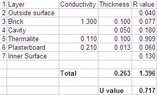

You are unlikely to see a return on £400. Assuming 100mm Thermalite blocks for the inner leaf, my dodgy calcs show your current walls might have a U-value of just over 0.7:
This is already as good as 1930's cavity walls with CWI. Add CWI to your walls and the U-value drops by just 0.3:
This is not much of a saving compared to a 1930's house, which would see an improvement of over 1.0.
I'd look for other reasons for downstairs being cold. Have you tried heating it? ;)
