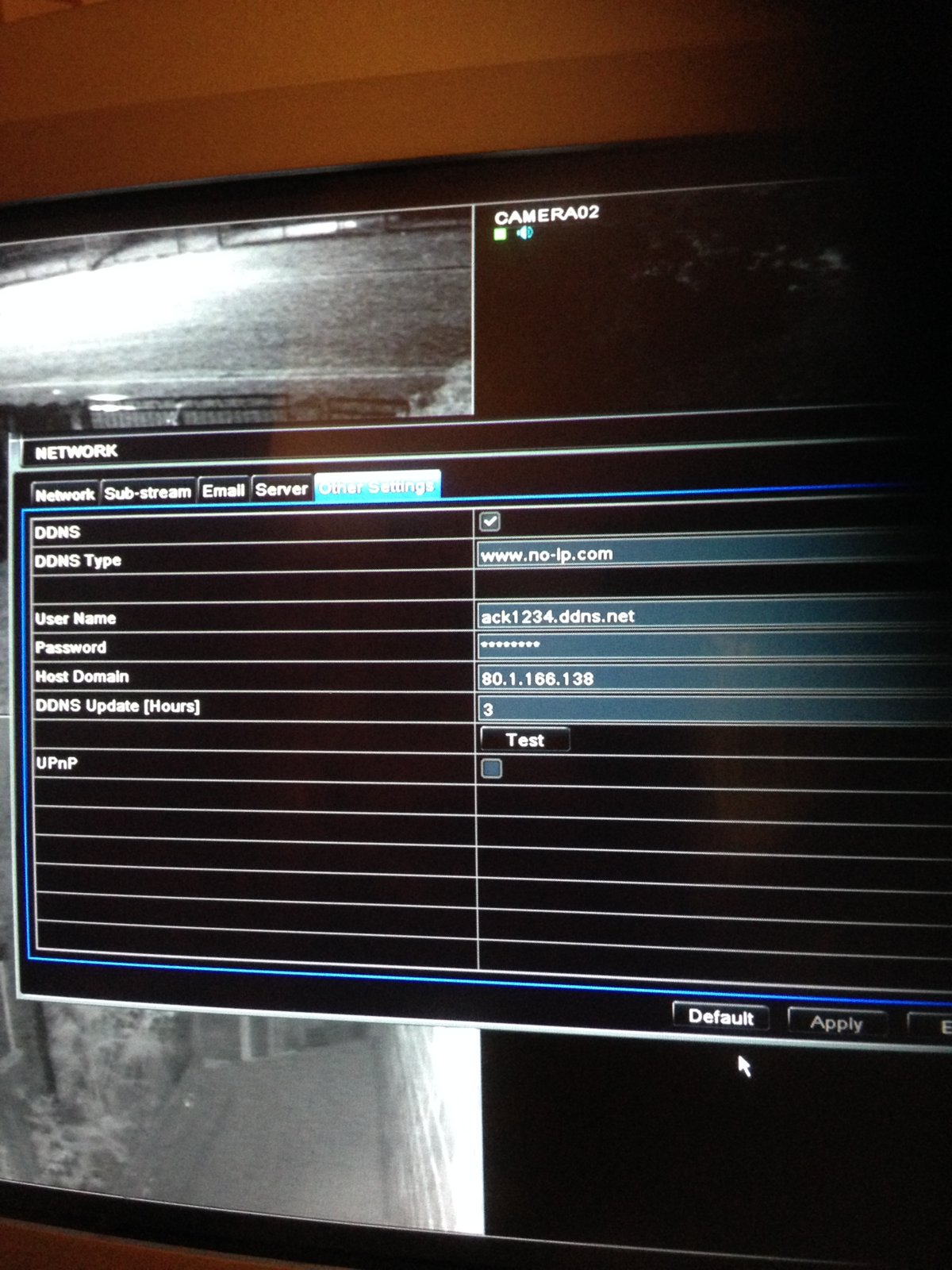

Got two dvrs one is floureon kit with 4 cams still messing with that but have got it connected to Internet and can view from the TopsView app however this does not accept two of the cams already up . So the Dvr I'm using at the moment is a genie cctv model LTDVRSE16 but I can't find an app what will connect to it .for the floureon I used a code that I scanned to phone but the genie doesn't have one when you turn on thanks

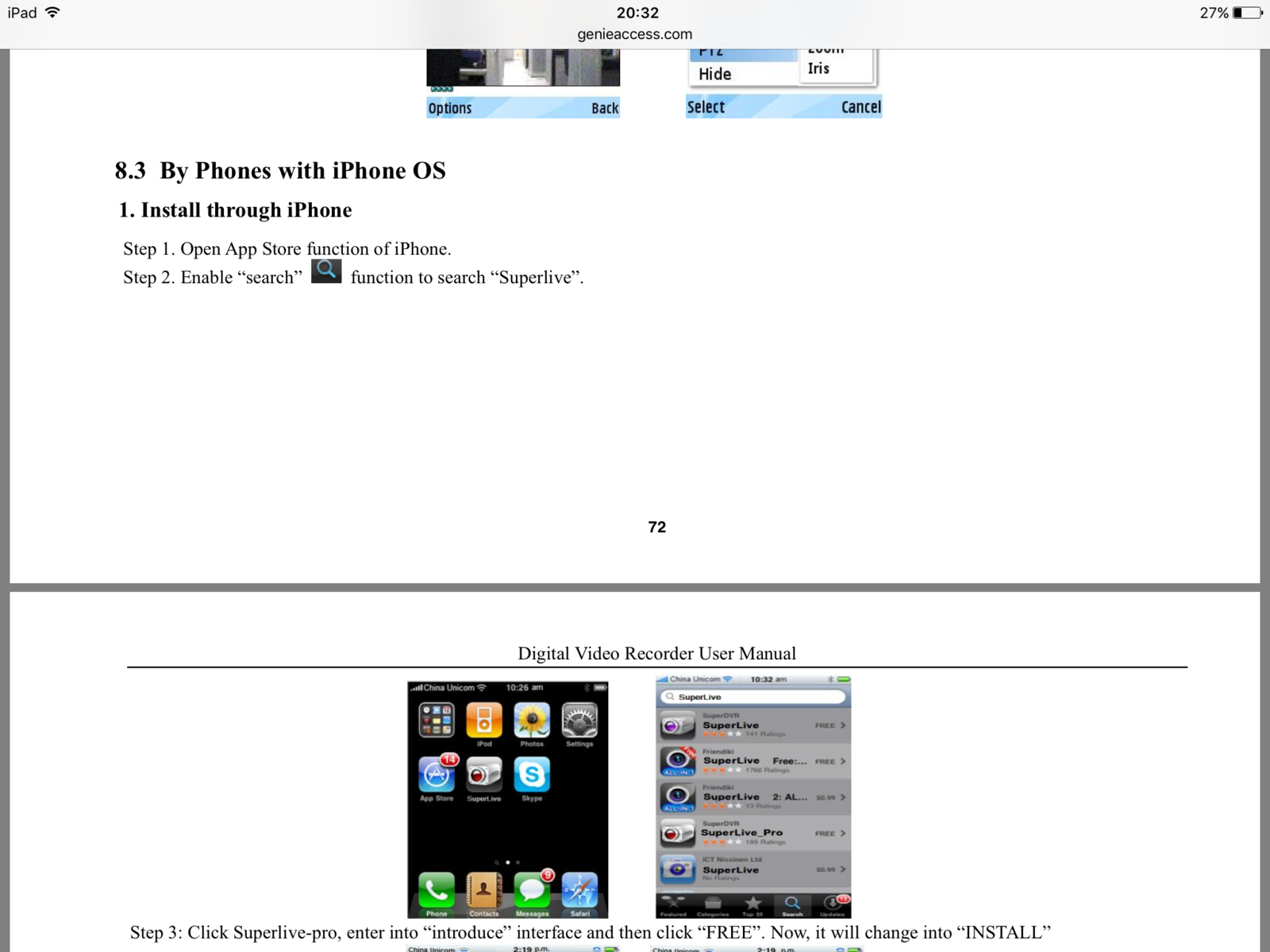

The genie app used to be Superlive
But I don't think it's around anymore as it's very old , plus that dvr you had to create a ddns account and needed port forwarding ....
Thanks for that it works on superlive pro on wifi but times out on 4g .

Right so think I got the Ddns it said at bottom successful and then I applied and it says config successful when I test what do I do now thanks
