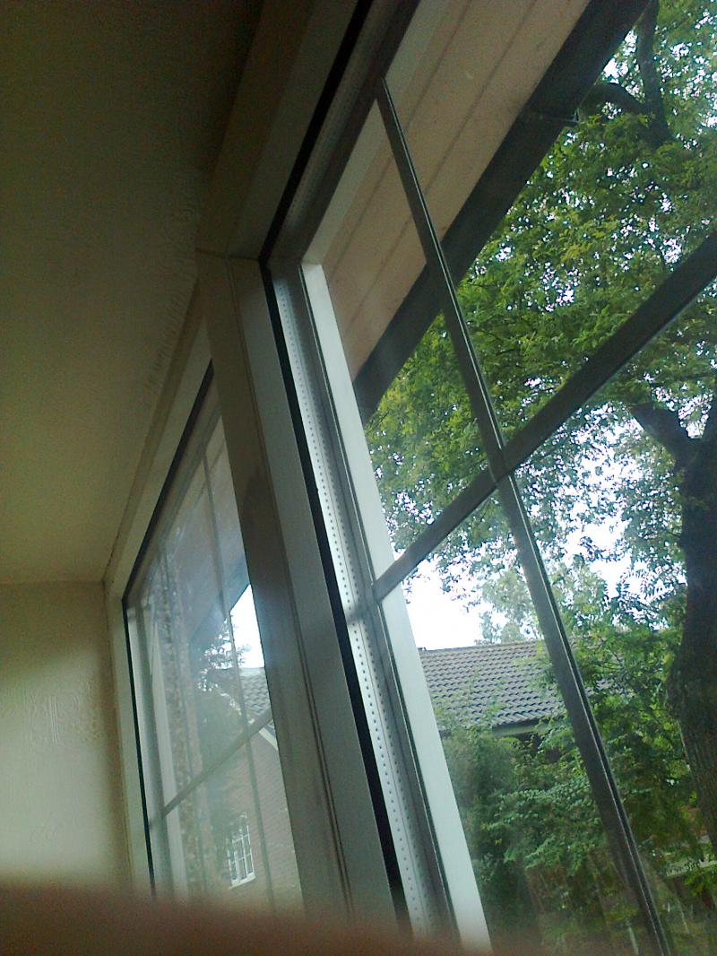

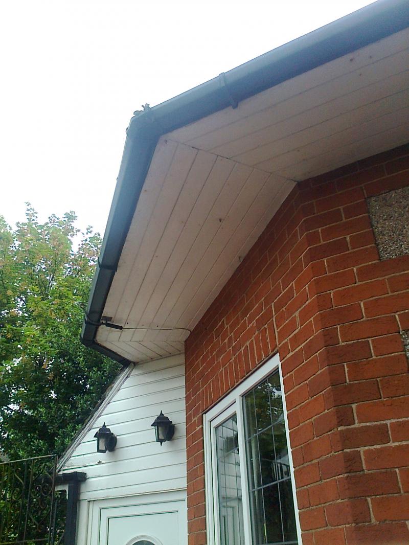

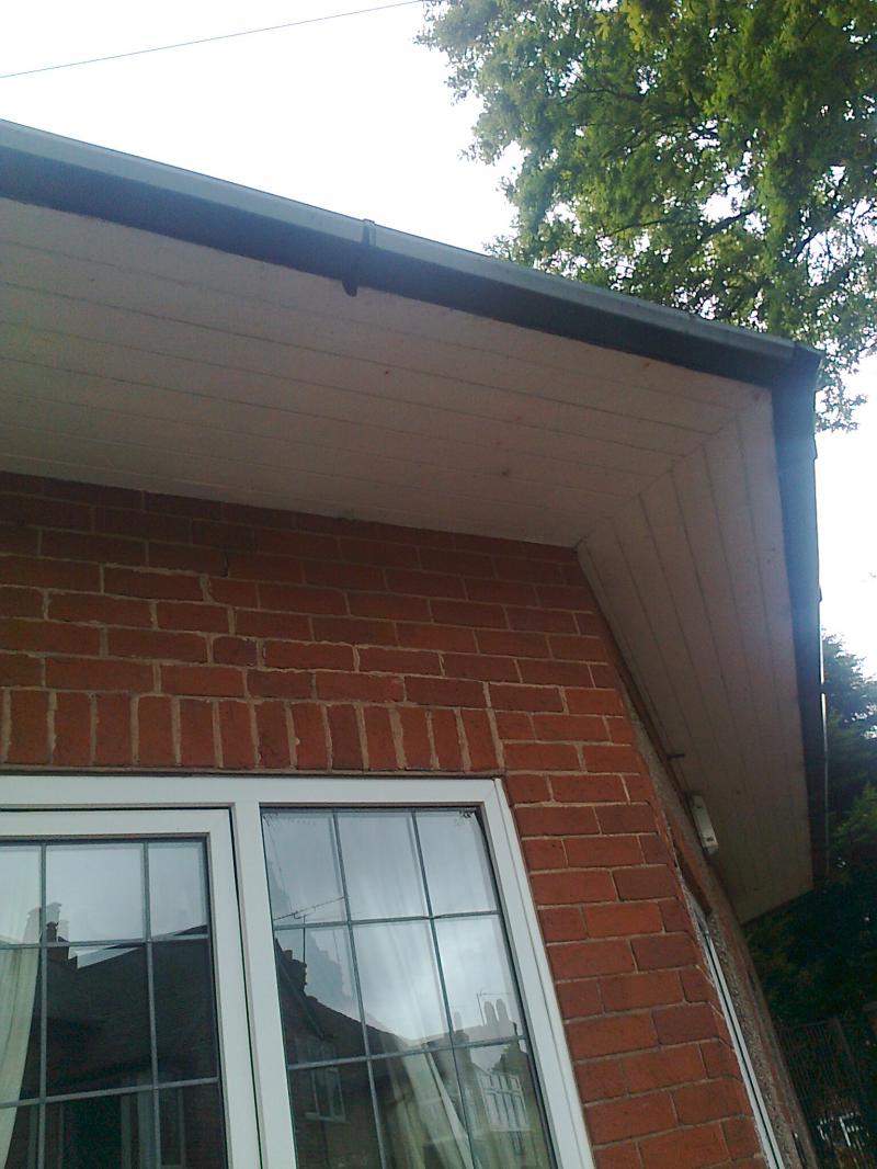

Just bought some cctv cameras that I should receive next week. I'm just trying to figure out the best way of setting everything up. My plan was to put the DVR in the loft and have a hdmi cable going from that to the tv in the bedroom. I was originally thinking of just using cable clips to secure the cable to the outside of the building and then get them into the loft somehow however I was wondering if I could conceal the cable via the fascia's.
The fascia's look to be just above the ceiling but from the outside it looks like the beginning of the roof. I've been into the loft but can't get anywhere near the base of the roof. Is it a case of drilling a hole into the fascia and hoping I don't hit any cables or pipes in the loft and then pushing the cable up and hoping it comes up somewhere I can get hold of it?
Any help would be greatly appreciated

There are various tricks...
Drill a hole in the soffit and, from the outside, push a couple of metres of cable up through the hole. Take a long stick (bamboo cane, fishing rod, length of trunking or conduit, etc.) and tape a hook onto it - make the hook from some stiff wire like a coat hanger. Go into the loft and try "fishing" for the cable. When you hook the wire, twist the stick to reduce the chance of the cable dropping off the hook as you pull. You may want to have an assistant outside pushing/guiding the cable up through the hole as you pull on the inside (or vica versa).
If you can see the hole from the loft, you could tape a loop onto the end of a stick ond drop it over the hole like a snare. Then, from outside, push the cable up through the hole and the loop. Twist and pull the stick as above.
Drill a large (8-20mm) hole in the soffit. Poke a long length of stiff wire or a thin (fibreglass) rod through the soffit and into the loft, leaving 1'/30cm hanging out. From inside, tape the cable onto the end of the rod (overlap by 4"-6"/10-15cm) making sure that the tape covers the end of the cable and the rod (this will reduce the chance of it snagging). Go back outside and pull the end of the rod to pull the cable through.
As above but tape the cable to the rod first and use it like a giant needle to pull the cable in from outside.

if i can feed the cable into the loft that would be best as I can then clip it to the joists and there will be an easy route to the dvr. My two main concerns with going through the soffit is 1) I would drill into a cable or pipe lurking in the loft and 2) that I won't be able to find the cable in the loft. I think it would look smarted on the soffit and easier to mount (wood screws/sef tappers without needing raw plugs).

You are very unlikely to hit a cable or pipe in the eves, above the soffit. In the unlikely event that there is something there, if you drill carefully and stop as soon as you get through, you won't damage anything.

You won't find any services in there. It will be empty.
I did this for two cameras at the front and two more at the rear.
What I did each time was to push in several metres of poly rope from outside so that it was loosely coiled above the soffit, and then hooked it from inside with a long hook made from a clothes hanger on a stick. Then used the rope to pull through the cable.
I aimed the view of the two cameras to cross over diagonally rather than both looking straight down.
