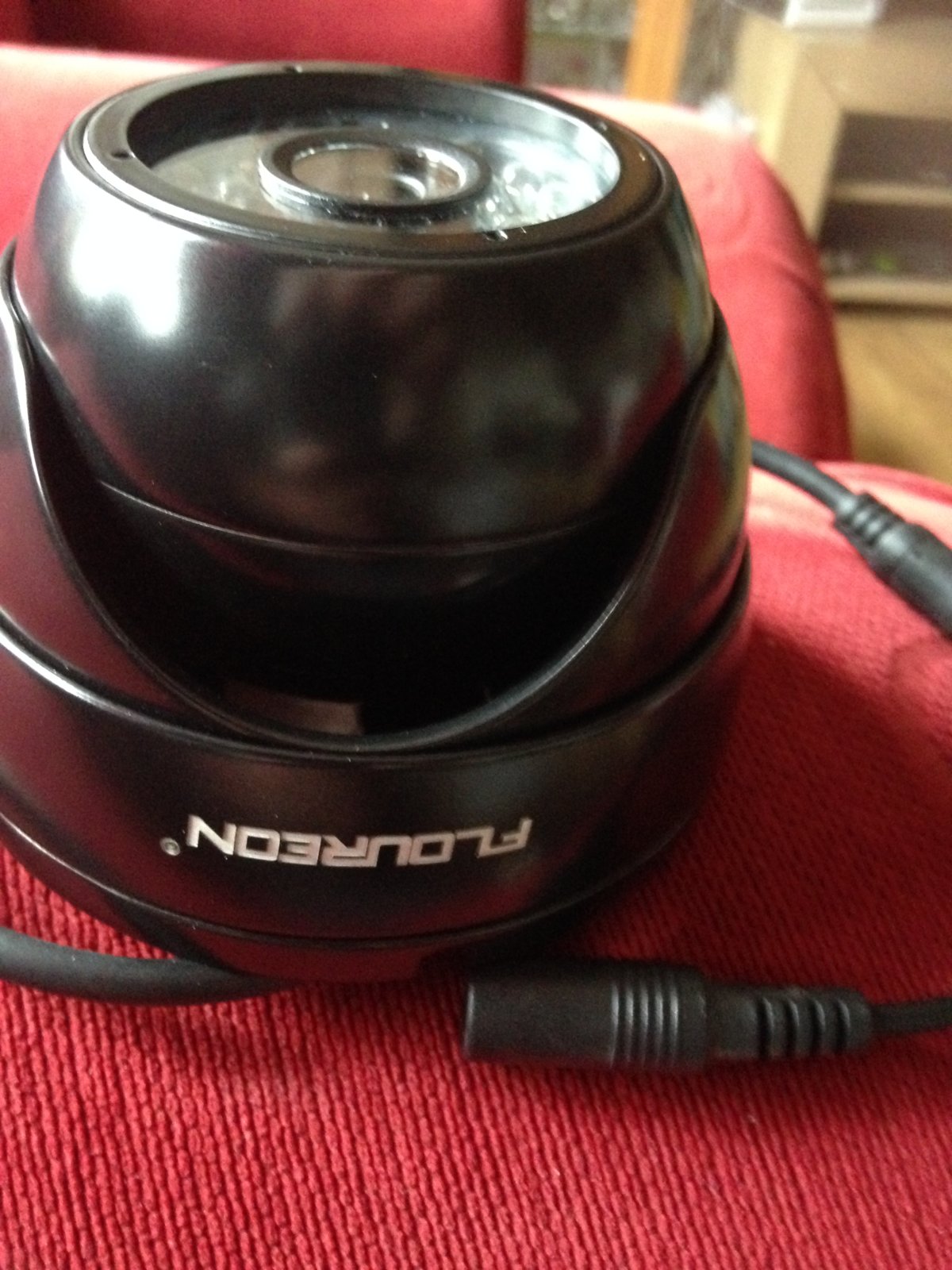

Sorted all problems had connecting Dvr to iPhone but now got another I have a genie 16ch Dvr got 3 cams on but just got a floureon 4cam kit the thing I got now is the floureon cams don't work on the genie do I need to change any settings on Dvr thanks
Don't think a camera with 1500tvl is going to work with a dvr that is 6-7 years old
Hope your haven't spent a lot on these bits
No 38 quid for the floureon kit but to be honest the Dvr that comes with it is abit cheap so if I wanted to add cams to the genie what cams do I need .the one I got up already look the same but different name and it's took me 3 yrs to connect to my phone thanks
Any standard up to possibly 600tvl cameras but they are going to look poor against hd cameras ! The other option Is a multi format camera so at least you can switch them to a better format at a later date
