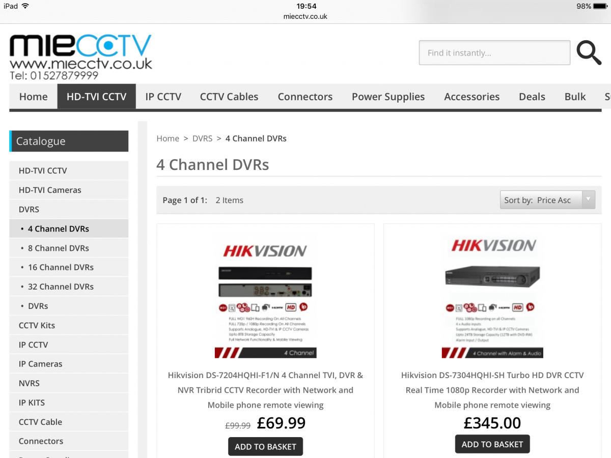

Hikvision....don't buy cheap Unknown brands as there is no support .....
Turbo dvr around £60
Wd purple HD £50 - £130 for 1-4 tb ( you need a 2tb min )
TVI camera £35 upwards each
All prices plus vat

Conventional systems are coax. They are analogue. And you need to either use shotgun cable (which is coax and power) or have a local power supply.
IP Cameras are digital, use cat5 network cable and the nvr powers them via Poe. Cable is easier to run, resolutions are better. And it's the future :) slightly more expensive but worth it.
Missed that bit! Potentially not then ... I spent about 350 so far on 3 cameras and nvr. Amazon warehouse for most of it!
Trade price + vat of course !
