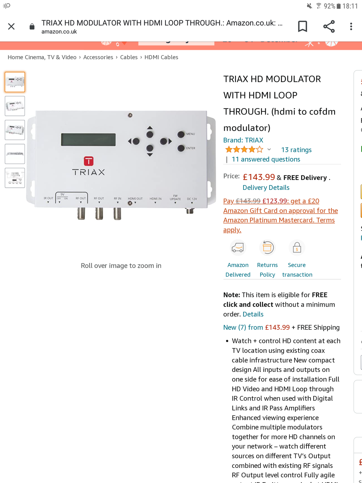

Is there a way I can convert it to wireless? And i want to my TV amplifier so I can view cameras on the TVs is there a way this can be done?
System has 1 LAN and 2 USB connections.
You need to connect your dvr to your aerial amp via a modulator. HDMI lead from dos to modulator which is then connected to your aerial amp. Screenshot_20201228-181105.png
