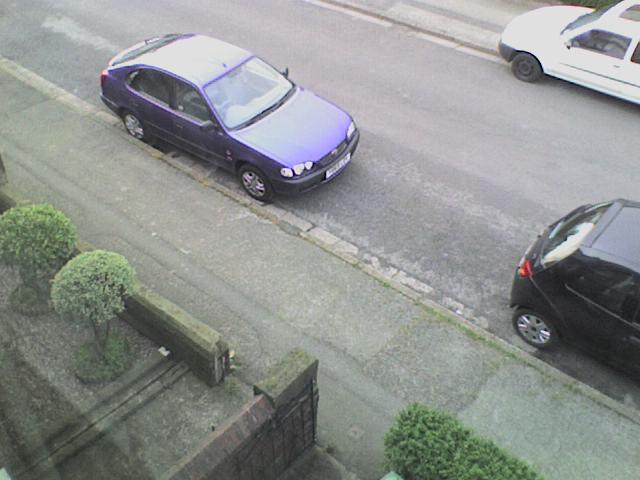

I have a panasonic BLC-131A
Its a wireless / wired network camera.
When I bought it, it was around the £200 mark. Let me tell you, while its fine for my purposes, it certainly isn't "evidence quality"
Also, when buying IP cameras, remember to factor in the cost of some monitoring / recording software. Panasonic supplies some free, but it will only let you view one camera at a time, the multi camera software is something like £200 - £300 IIRC
Here is a shot from my camera to give you an idea of the quality.
Notice, you cant see the blue cars registration number.
