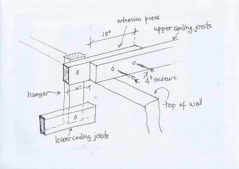

The wall plates are in and I've put up (although not yet fixed) the joists in the front bedroom. In the back bedroom, though, I've now realised that the rear wall is lower than the front one, so whereas the front ones sit nicely across the span, the ones for the rear would effectively need to rest about 8 inches below the top of the mid-span wall in order to be level with the wallplate on the outside wall.
The joists are just to support the ceiling - there's no plan to board the attic and it'll be knee deep in insulation so not even going to be used for storage - but I'm at a bit of a loss for how to support the rear bedroom's joists at a level below that of the mid-span wall.
As the wall is only half a brick thick and built with fairly flakey black ash mortar, I don't desperately want to try knocking / cutting slots out of it so as to effectively build the ends of the joists into the wall. I'd thought about joist hangers but they all seem to need to be built in, with 600+mm of masonry on top, which doesn't apply here.
One option that seems vaguely feasible is to put up a sort of ledger plate along the top of the internal wall, bolted to the brickwork, and then to use speedy hangers off this. Not convinced that this wouldn't be susceptible to just pulling the top course or two of bricks off the internal wall, though.

The new ceiling joists at the back of the house are sitting on a wallplate on the back wall and span onto the mid span wall, but is only 8" higher not allowing for a std masonry hanger to work ? And you dont want to create pockets in the midspan wall due to the black ash mortar ?
Would this work?
using offcuts, screw a piece to the side of each upper ceiling joist so it overlaps the wall about 6",
Screw a vertical hanger of similar section to the projecting piece, and then screw the ceiling joist to that.
You would need to mark a line on the wall to ensure the ends of the lower joists are level.
There would also be a tendency for the joists to move sideways slightly while working, but you could secure them temporarily with a batten across the tops.
Wouldn't take much weight, but if you're not using the ceiling for storage.....
It would be a lot better Tony if he already had a bit of overhang to the joist to start with rather than adding extension pieces, and I would use those large toothed timber washers for a bit more strength.
Agreed; I just assmed his upper ceiling joists were already in. It's a bit Heath Robinson, but would avoid drilling/hacking the wall right at the top.
