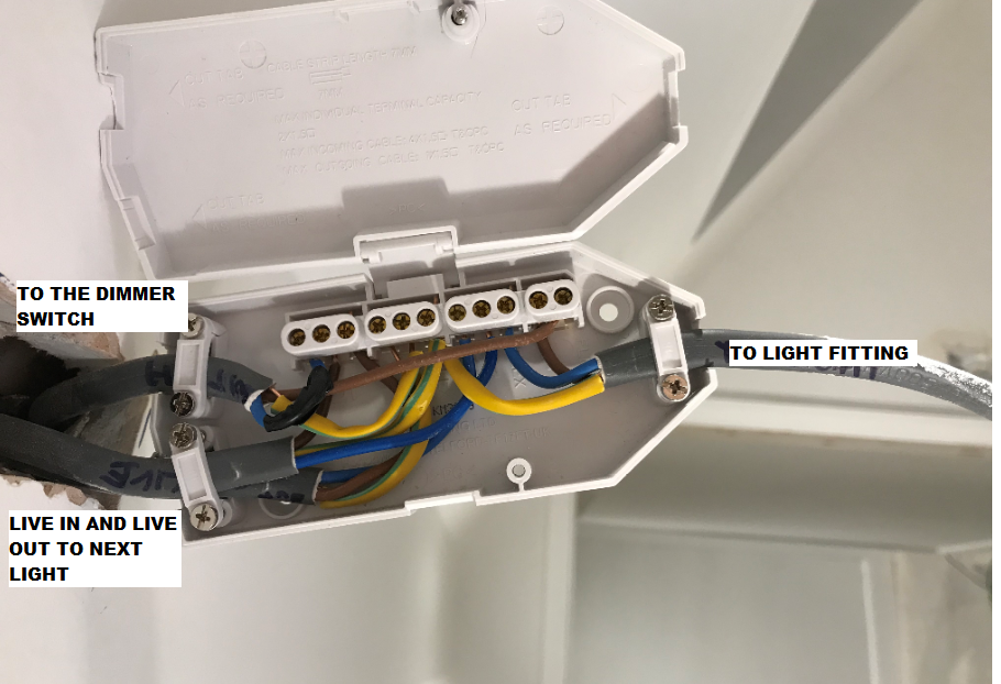

Please advise if this wiring is correct?
I had followed a picture on here from an old thread using the exact same box, but I have since found different wiring examples on the web using standard junction boxes.
Yes, it looks correct.
You have the switch cable's Brown and Blue the other way round than is 'usual' but it doesn't matter.
Thanks EFL, yes it was the switch-live I noticed was different on the other pics but as long as it still does the correct action that's great. thank you for your response.
