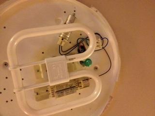

I attached pictures of my ceiling light.
All of sudden it stopped working. I though it might be just bulb/tube and replaced it but still does not work.
All other appliances in the same room are working fine.
I have no idea how to figure out what is wrong.

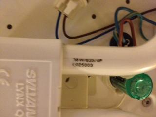

Here is what I can read on the tube:
38W/835/4P

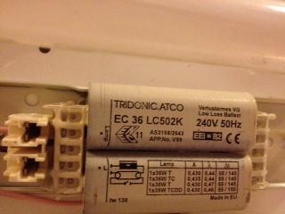

Here is what on the choke:
EC 36 LC502K
240V 50HZ

Might be the starter, they are a £1 or so and available from any electrical supply shop.
http://www.tlc-direct.co.uk/Products/BGFSU.html
Your is show in the third picture, disconnect the silver bullet looking item and take that in so they can supply you like for like.

Chri5 the silver thing looks more like a capacitor to me and the green thing is the starter?
What you're reading on the tube is 38W/835/4P Wattage/Colour Temperature/How many pins it has
Is the old tube you're reading the code off? Is the new tube 4P or 2P?
Green bit is the starter. I will check if it right size.
The new tupe is 4p.
I think tube has 4 pins I will check pins when I will get home.
if the tube in the photo is the old tube then it has 4 pins.
If you have the right tube and the right starter (and both of those are working fine, then it will more than likely be the choke that's failed.
Having said that I would be 99% sure it's the starter or the tube, new ones are sometimes DOA.
This is the choke you will need, if you wanted to change it
http://www.ebay.co.uk/itm/Tridonic-...SetTopBoxes&hash=item3371ada6ee#ht_4994wt_951
Personally I would just swap the fitting for a new one, as changing the choke is going to be more trouble than its worth
