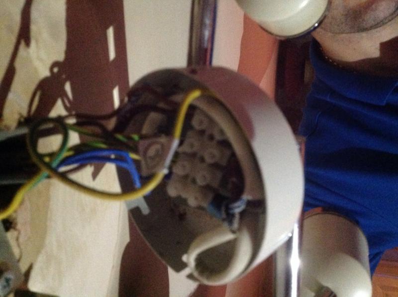

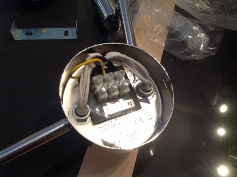

We are trying to replace the kitchen light. The house was rewired 12mths ago. When we have tried to take the light off it is different to the one we want to replace it with. Can anyone please tell us which wires need to go where. I have enclosed photos (if you can't see them please check in album 'ceiling light'). Thank you in advance
The only difference is that your new fitting is missing a fourth terminal for the loop wiring.
Get another terminal block for this and wire the rest as per the blocks on your fitting.

Back to the op, the picture of the ceiling wiring isn't clear enough to give you a quick answer.
We need to know how many CABLES, and how many WIRES and their colours emerge from each CABLE.
Also need to know for certain if just the one light is operated by the switch, as this would make the wiring different.

an additional three brown wires going to a fourth connector that we do not have in the new light fitting. Please help
Lights with just L/N/E connections and no place for the live loop to go are commonplace.
