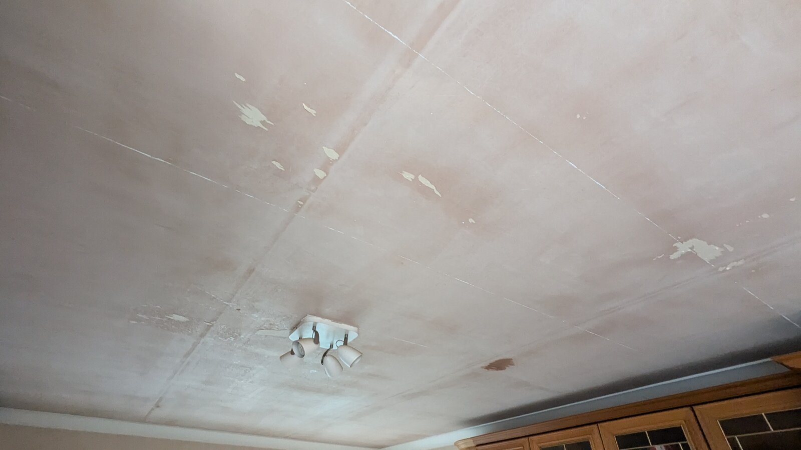

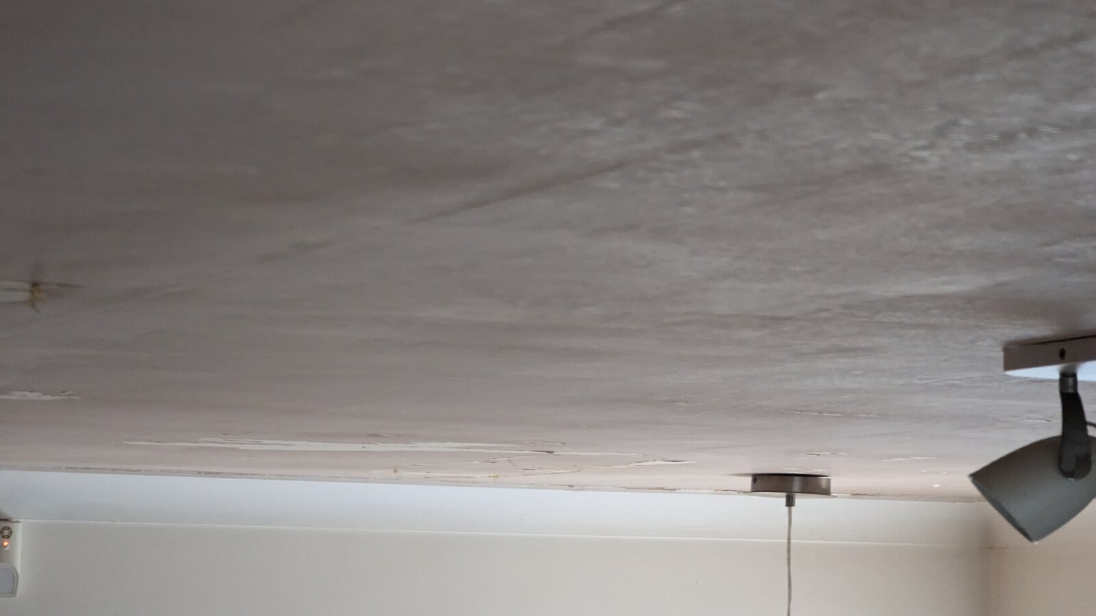

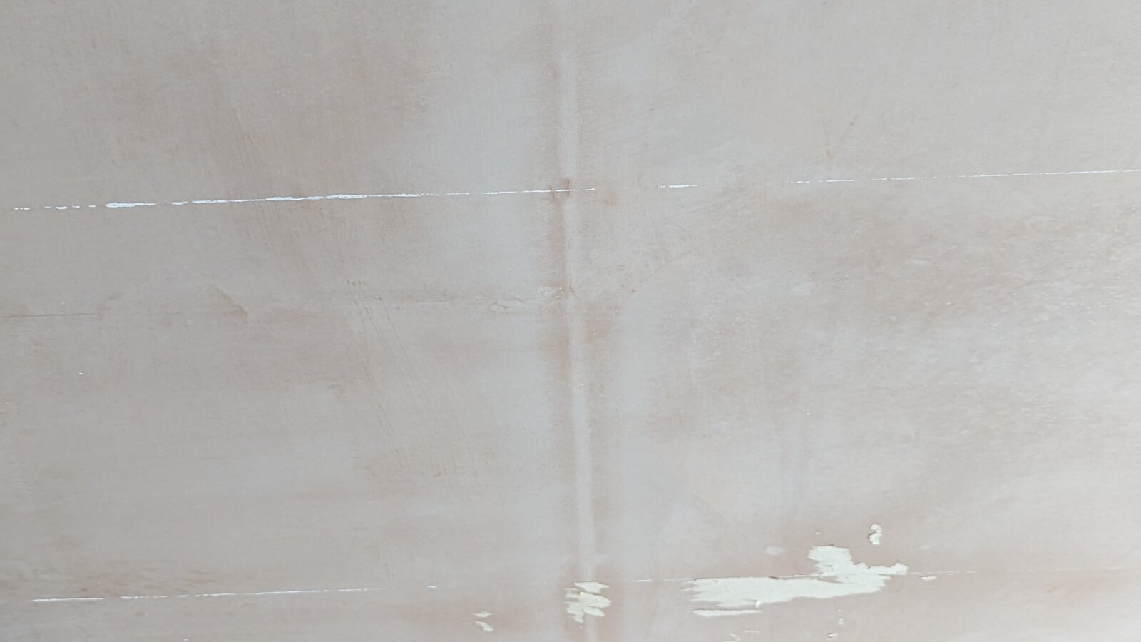

I've taken the wallpaper off the ceiling. There are lines which presumably is the tape but apart from that it looks pretty good?

I'd bodge a cheap orbital sander on vaccum and run over ceiling then gardz to neutralise paste.
See how it looks.
Can't tell from picture.
How much making good will it require as is?
I know it will have holes in soon
