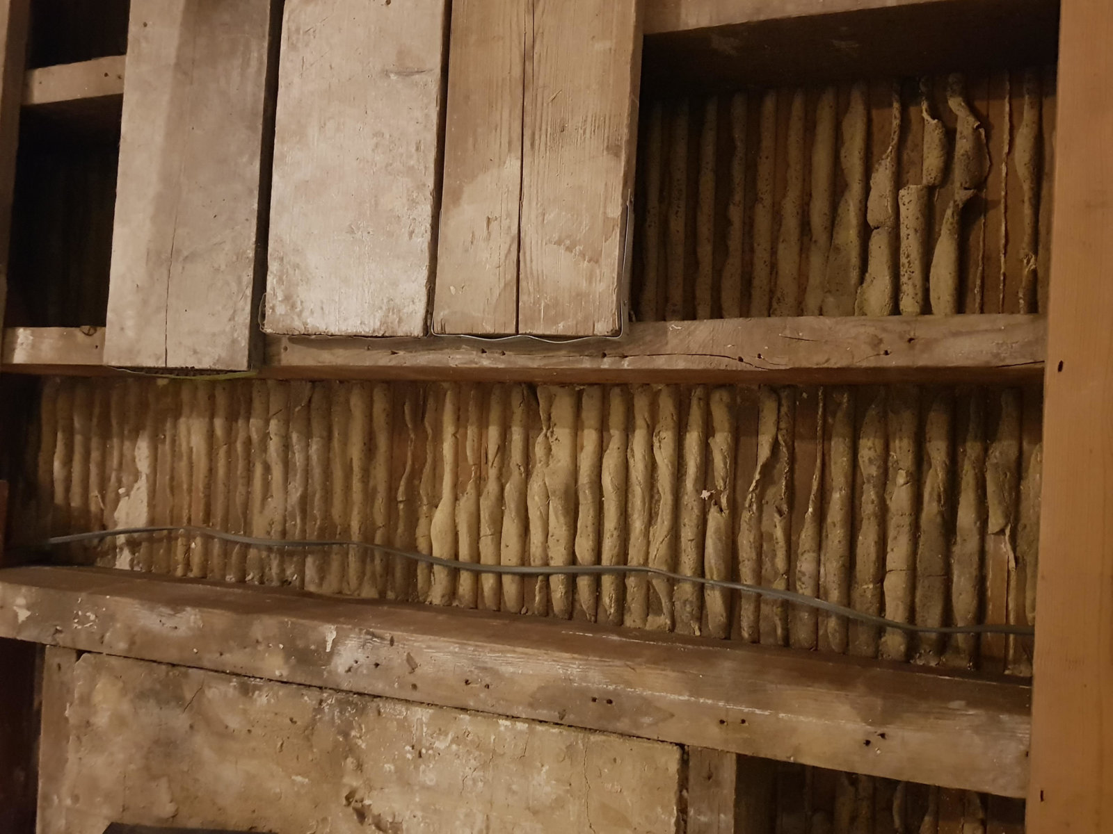

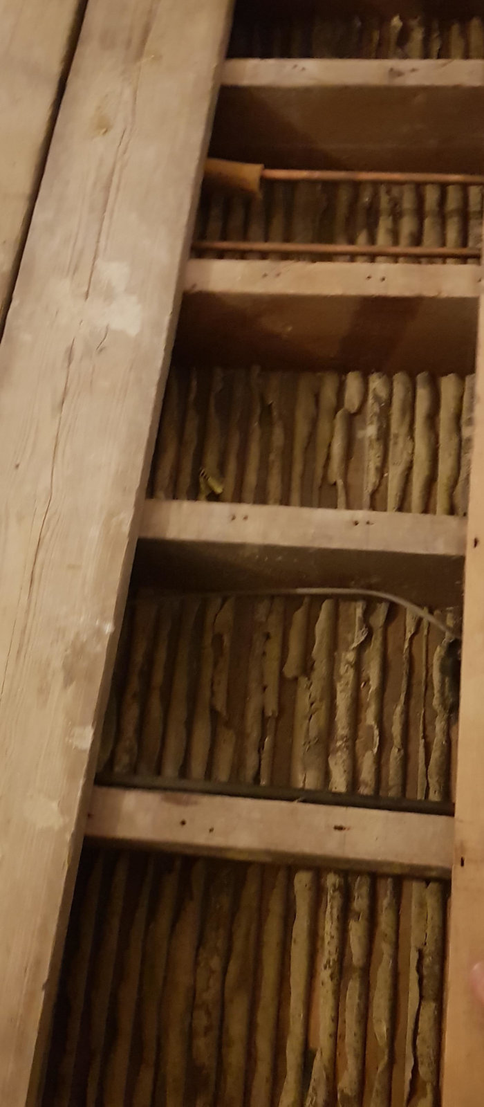

The walls have been insulated and boarded and whilst i was doing this job i have cleared out the floor voids. The ceilings are lath and plaster construction. The ceilings are as flat as you can get with cracking in areas. The timber laths are in very good order as is the plaster in 90% of the areas.

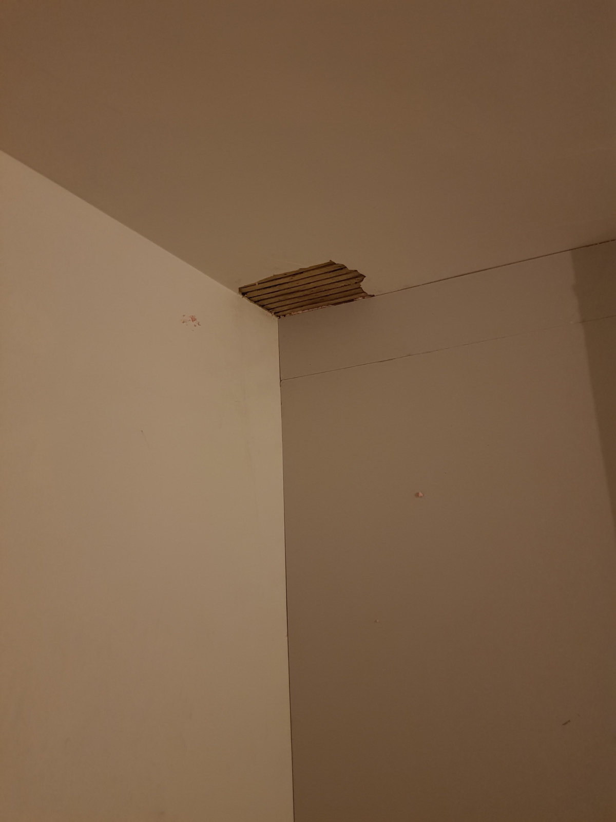

Where i have been clearing out the floor voids i have checked for any loose plaster and removed where found. This has left a patch of approximately 300x300 in most room rooms with a few more in the larger room. 1 was even self inflicted after Henry took a nose dive off the scaffold board after inhaling to much debris from the void. .
I am not going to kick the lath and plaster down. It does not need it. Structurally its sound, no sagging etc. What is the best way forward? Do i get the plasterer to patch and then skim the lot or do i overboard and then skim? Over boarding will probably cost me £50 a room and half a day so not preferable if it can be avoided but at the same time i am happy to do it if it will give benefit in the long run. If these ceilings can be patched with no future issues then i will not bother boarding.

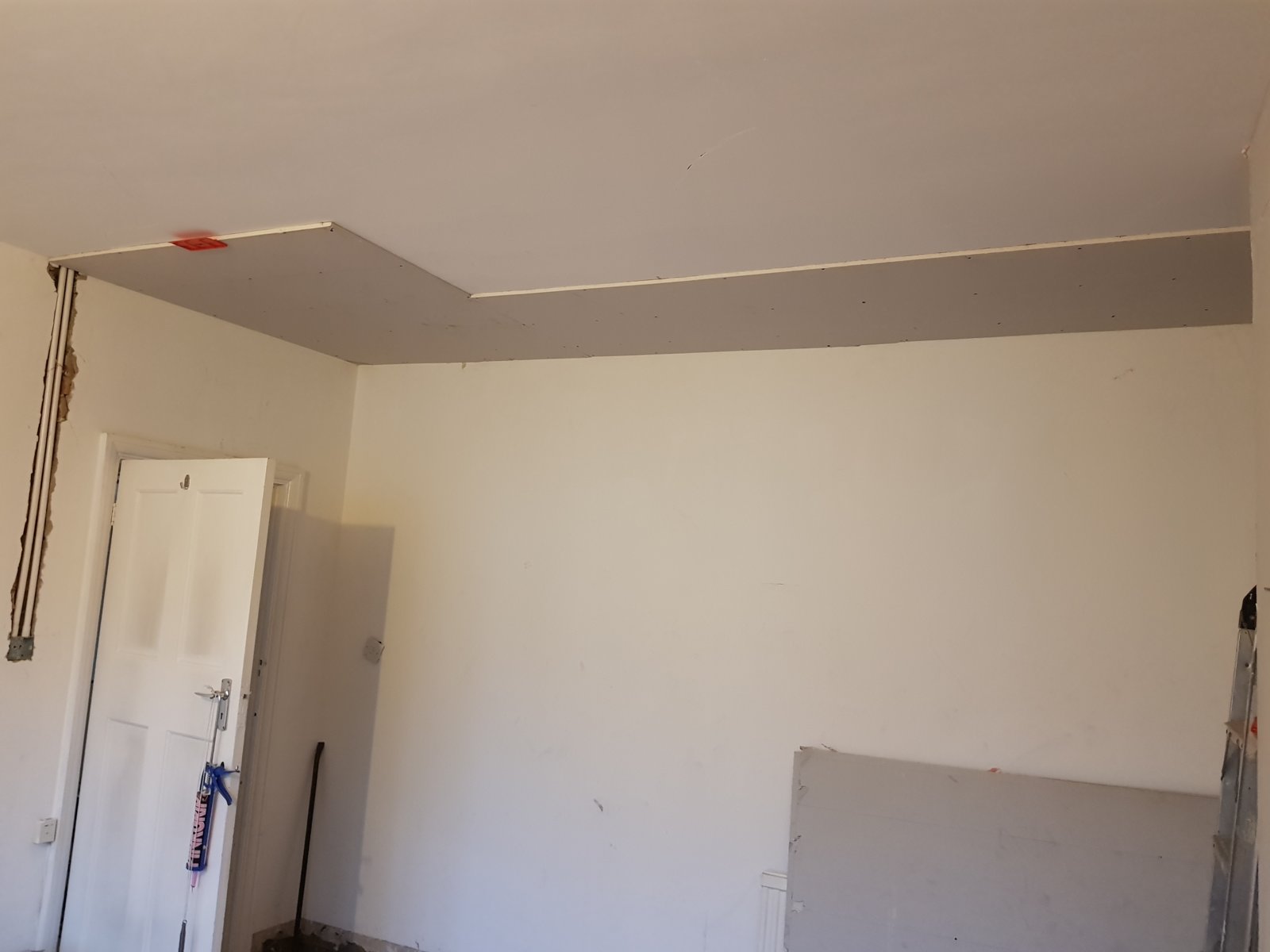

yes they’re easy to use. I only use one but you can use them in pairs, screw it through the previous board into a joist, then it takes the weight of that end of the board leaving you to fix the end your holding with your other hand.
Only ever done 6x3s for ceilings, don’t fancy 8x4s, so cant comment.

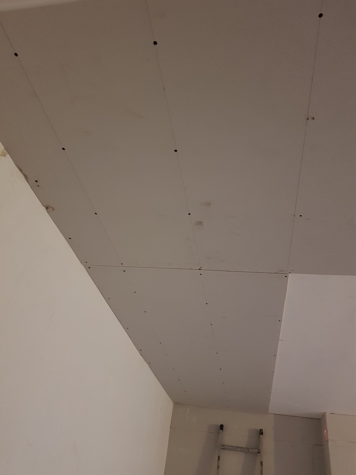

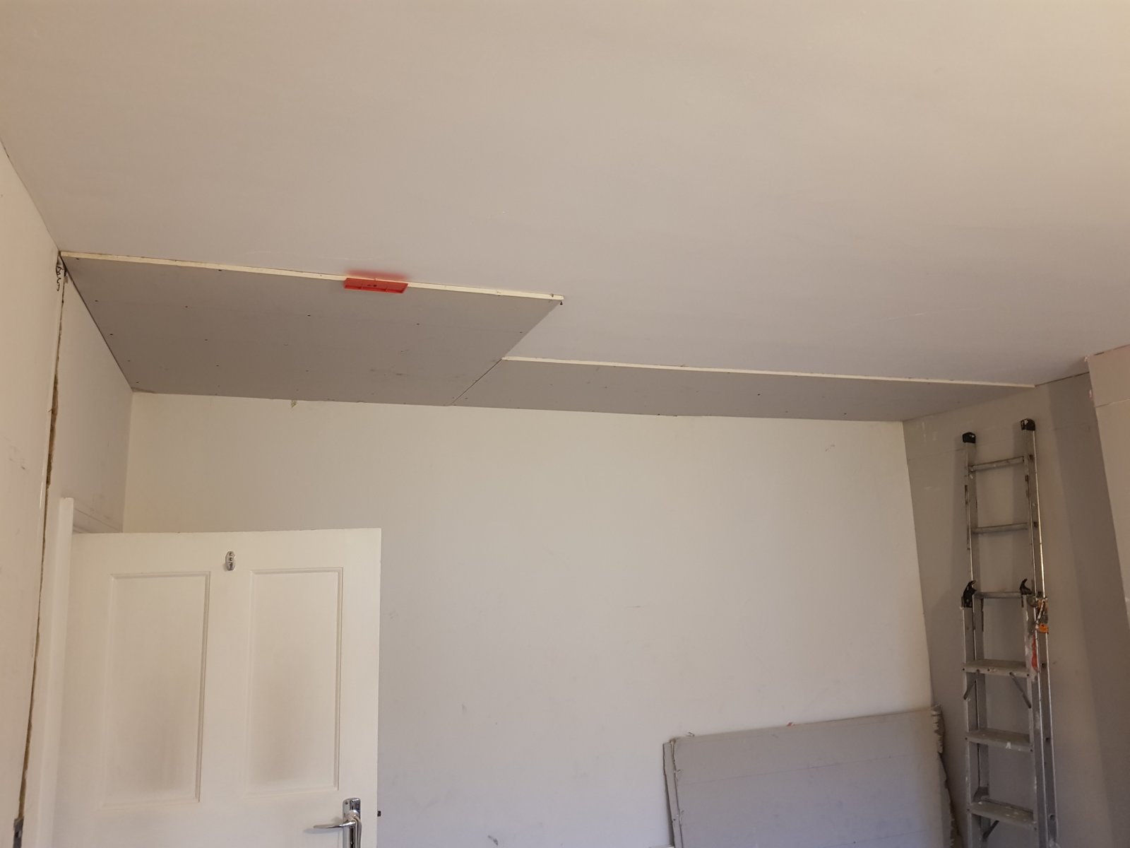

So just gave the board mate a go and it works a treat. Full boards are impossible but boards cut down to 900-1000 work a treat.
How many fixings are recommended?
Also my joists are spaced at 325mm which means standard boards dont work anyway and need to be cut smaller in width.
1st 2 boards up as below
