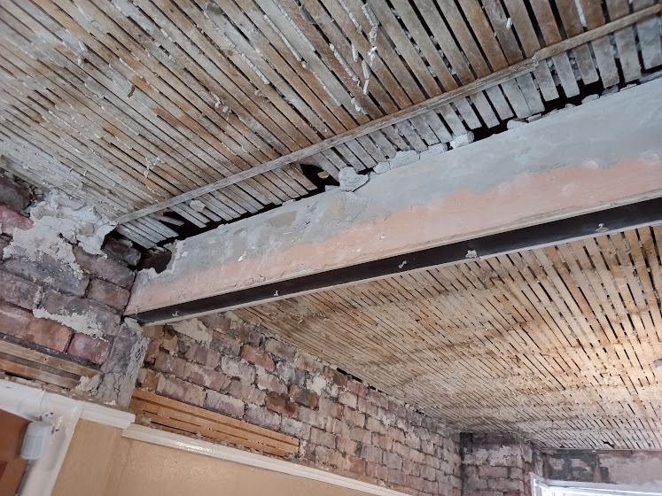

I have had the artex ceiling removed by an asbestos contractor. See photo
Should/ can I remove the lathes on the ceiling in preparation for a plasterboard ceiling.
Should I point the walls before plastering
Laths don't need to be removed unless they impede the fitting of new boards, and walls don't need pointing unless there are loose bricks.
