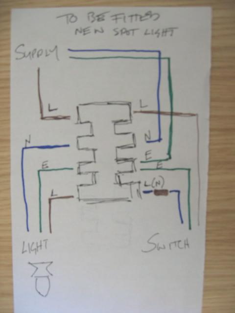

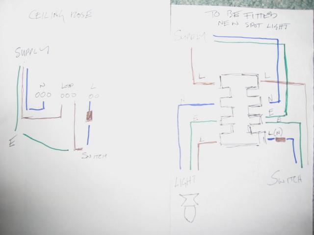

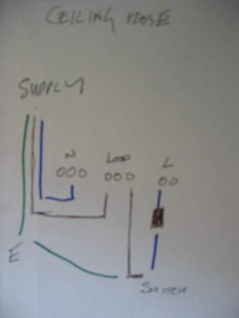

Basically I'm wiring a spot light in-place of the existing ceiling rose light.
Current Ceiling Rose Wiring
New Wiring Plan with chockblock
Both Plans

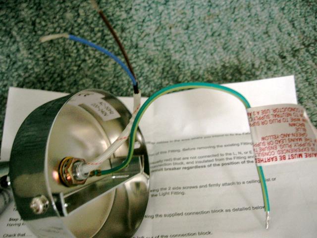

New Spot
Instillation Instructions
I'm hoping the photos explain it properly, but have i got this right?

The wiki is your friend.
Answer = yes
ta mate,
i did consult the wiki, i just needed to check i had it right before i commenced.
Thanks for your help
