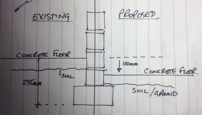

Hello,
I need some advice on converting a victorian cellar.
I would like to lower the floor buy just 100mm for a bit more headroom, the floor is cracked so needs replacing anyway. Will this be possible, what are the regs for this?
My foundations with existing and proposed floors are in the sketch attached.
Also which is the best way to waterproof the walls and bridge the join to the DPM under the new floor? I am on a budget and will be doing the work myself but would prefer a plastic membrane type as opposed to a slurry.

As above, if you are lowering the floor then you need to go through a structural engineer. Bear in mind that to lower it by 100mm you are probably digging down more than 300mm to fit screed/insulation in.

You shouldn't have any trouble lowering the floor by 100mm or so. The party wall will easily retain the small amount of material on the opposite side.
Keeping it dry is much more of a problem and one that needs to be carefully thought about and designed.
Thanks for the comment Ronny, could you just explain what you meant by this?
The image I attached was actually of an internal wall, I dug a hole next to an external one and it has an extra coarse of brick under it with a wider footing.
So in your opinion Ronny just 100mm lower would not be a problem?
