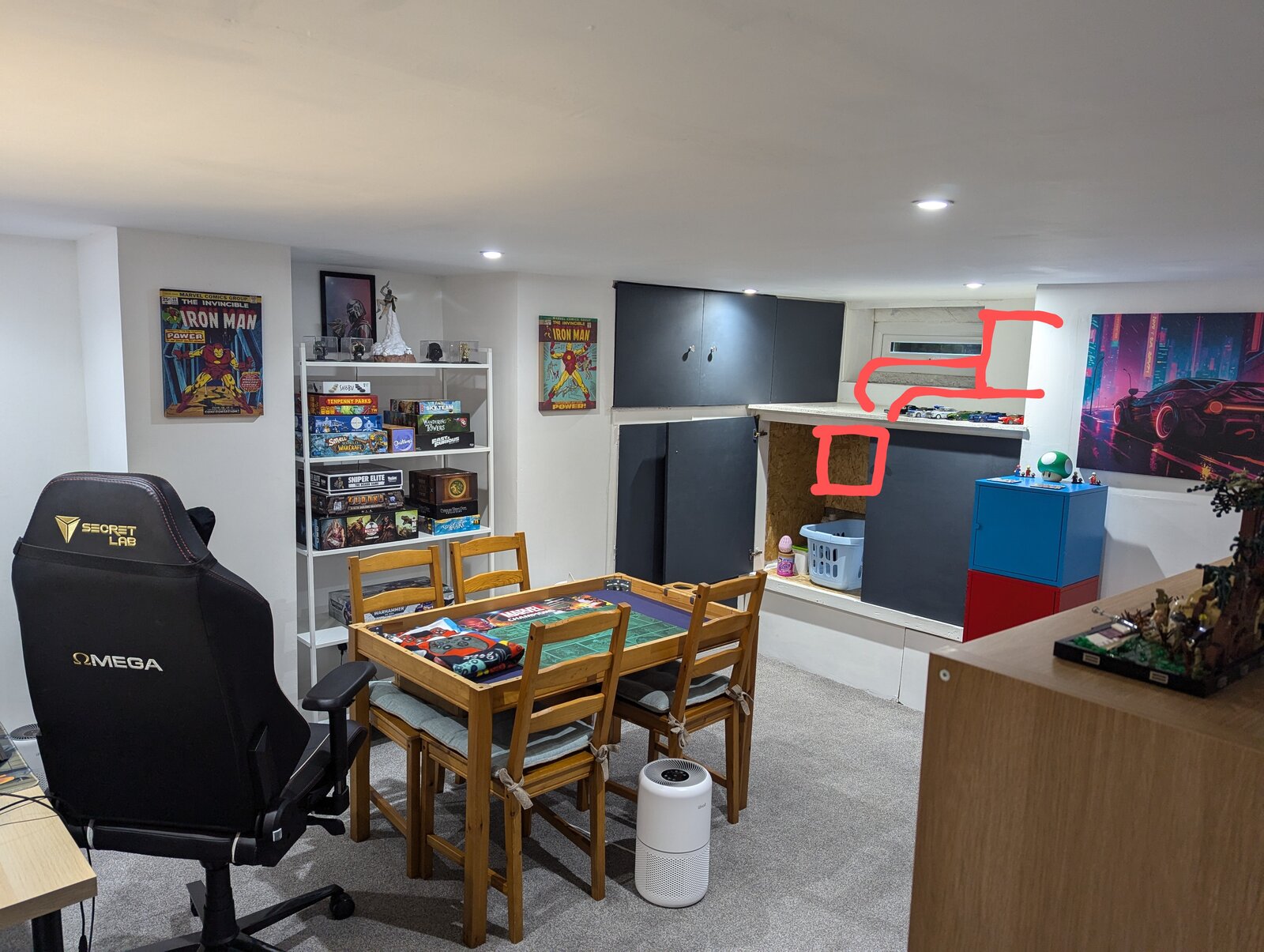

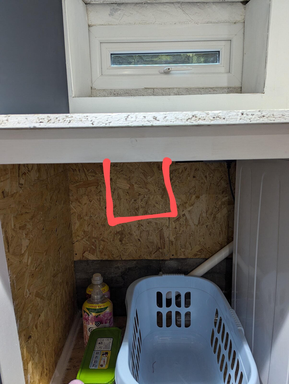

Thinking of getting an extractor system placed in the far corner by the washing machine, picture attached, as the wall is external and backs onto a pit on the other side. Or on top of the washing machine cupboard for better access and ducting running out the back of the washing machine cupboard.
The room is 5m by 4m so would an extractor in the far corner be powerful enough to extract the air from the entire room or would It just extract the air closest to the corner? Was looking at a continuous DMEV system to constantly extract stale air and bring in fresh air through the air brick.
But, I am wary about drilling a hole through the cellar and potentially disrupting the equilibrium of the cellar and unsure whether to just keep the dehumidifier running and deal with the upkeep.
