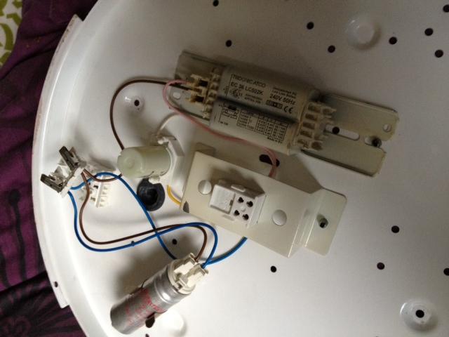

See attached images:
Few weeks back, my celling light stop working and I though it is light bulb or starter so I replaced both, but still it does not work:
I used following light bulb:
(Sylvania® Lynx QE 2D Compact Fluorescent Lamp 4-Pin 2850Lm 38W)
http://www.screwfix.com/p/sylvania-lynx-qe-2d-compact-fluorescent-lamp-4-pin-2850lm-38w/87333?
I can read following from the choke:
EC 36 LC502K
240V 50HZ
I am not sure I am using correct light bulb.

Well the information on your link says "Operates on Electronic Ballasts Only" but you have what looks very much like a standard choke - a coil of copper wire on an iron core - so that's not a good start. :( :( :(
Could you point me which light bulb will work with this choke please. I can go back to screwfix and change it again.
I am not expert and have no idea which light bulb should work here.

I'm not sure why you are wasting time and effort (several posts) and visits to shops -
You would be better off just replacing the whole unit - much cheaper prospect.
I'm sure you will find a similar model at your local electrical store.
