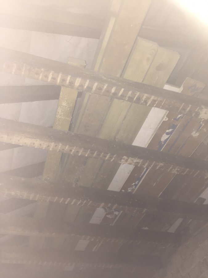

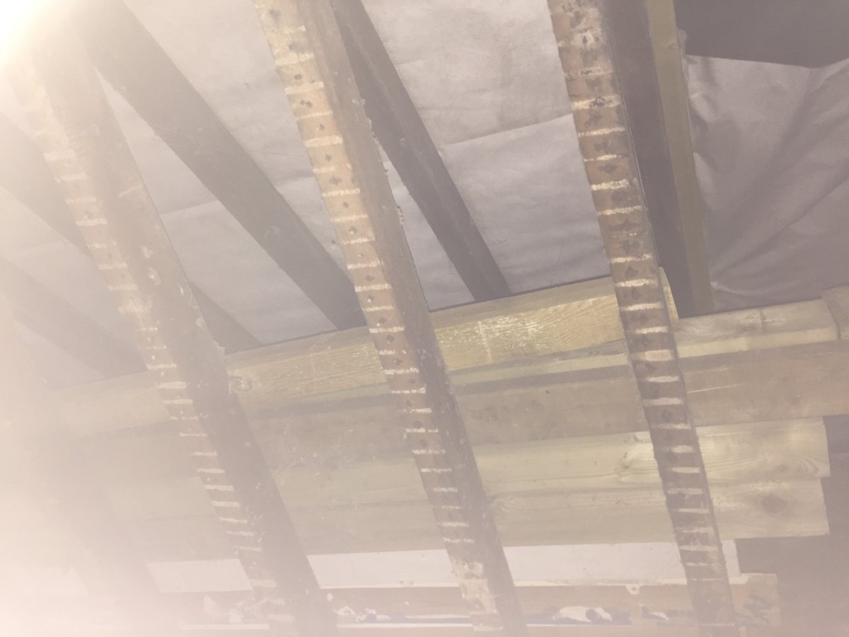

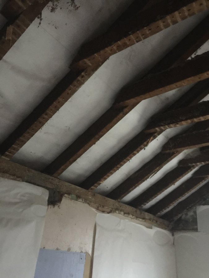

This is for a first floor bedroom ceiling with pitched roof and two external walls. Currently it is all open upto the roof. There are ceiling joists but no ceiling at all. Previous broken fake ceiling is completely removed.
I bought the Small 45cm x 120cm cellotex boards as that is the size I can fit in my car and carry upstairs on the windy stairs.

I will still have access to the space above but a crawling space. If this helps, this is a rear bedroom of a 2up 2down Victorian mid terraced house with kitchen extension. The said bedroom is above the kitchen. It has slanted(pitched?) roof. Will see if I can attach pictures.
Joist depth is 10cm only. Will I have to compress 300mm wool? Whilst there is no floor or covering above joist there is some timber perpendicular to joist in the central area running across full length of the room. Don't know whether to call it stud, plank, 2x4 ? I believe this may be for access.

Pictures made it clearer. I am not a builder but have done similar insulation in a dormer bungalow, to building regs.
My advice - use Celotex on the sloping bits where the depth is limited. When I did mine (2008), Building Control required 125mm. You also need a ventilated 50mm air gap between the Celotex and the roofing felt, if the latter is the older impervious type. In theory you don't need an air gap if the roofing felt is the modern breathable type, though a gap is often recommended. So to get your 125mm you would need either to fix battens to the sloping rafters to increase the depth, or add more Celotex over the face of the rafters before fixing the plasterboard through it. In either case, I would fix at least 25mm Celotex over the face of the rafters, and tape the joints, to reduce cold bridging across the rafters, and to provide a vapour barrier (the foil layer) to prevent warm moist air getting into the cold space and causing condensation.
For the flat ceiling joists at the top, I would chuck 300mm rock wool in there as you plasterboard. Rock wool is more usual to insulate above a flat ceiling. In theory you need a vapour barrier there as well, so you could use foil backed plasterboard, or 25mm Celotex under the rafters (I don't know what trades would do - I was putting my ceiling above the joists, to leave them exposed, and working upwards I used plasterboard, 25mm Celotex and then rock wool, but that's probably unconventional, though Building Control were happy).
Maybe run what I've said past your building inspector and see if this the kind of thing he was getting at.

Picture speaks a thousand words! The 50mm Kingspan between the rafters makes sense now, or if you can afford to lose the head height then you can save some hassle and put as much as you can get away with under the rafters instead, as Gerald says.
Yes you can lay the mineral as you go, but don't compress it. Put 100mm between the joists then lay 170 over the top in the opposite direction (unroll it as you perhaps)
The space won't be usable after you're finished : the won't be the room and even if there was your need some form of lift stilts and boarding so that you don't compress your mineral insulation.
