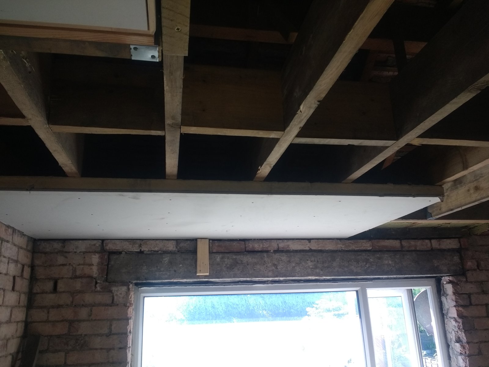

The plasterboard bonded stuff is nice (well it is when you get 7 sheets of 50mm for £50!) but otherwise vastly overpriced and completely ridged - makes it murder to get up stairs as it doesn't bend at all. I've just underboard my bedroom ceiling with it:
