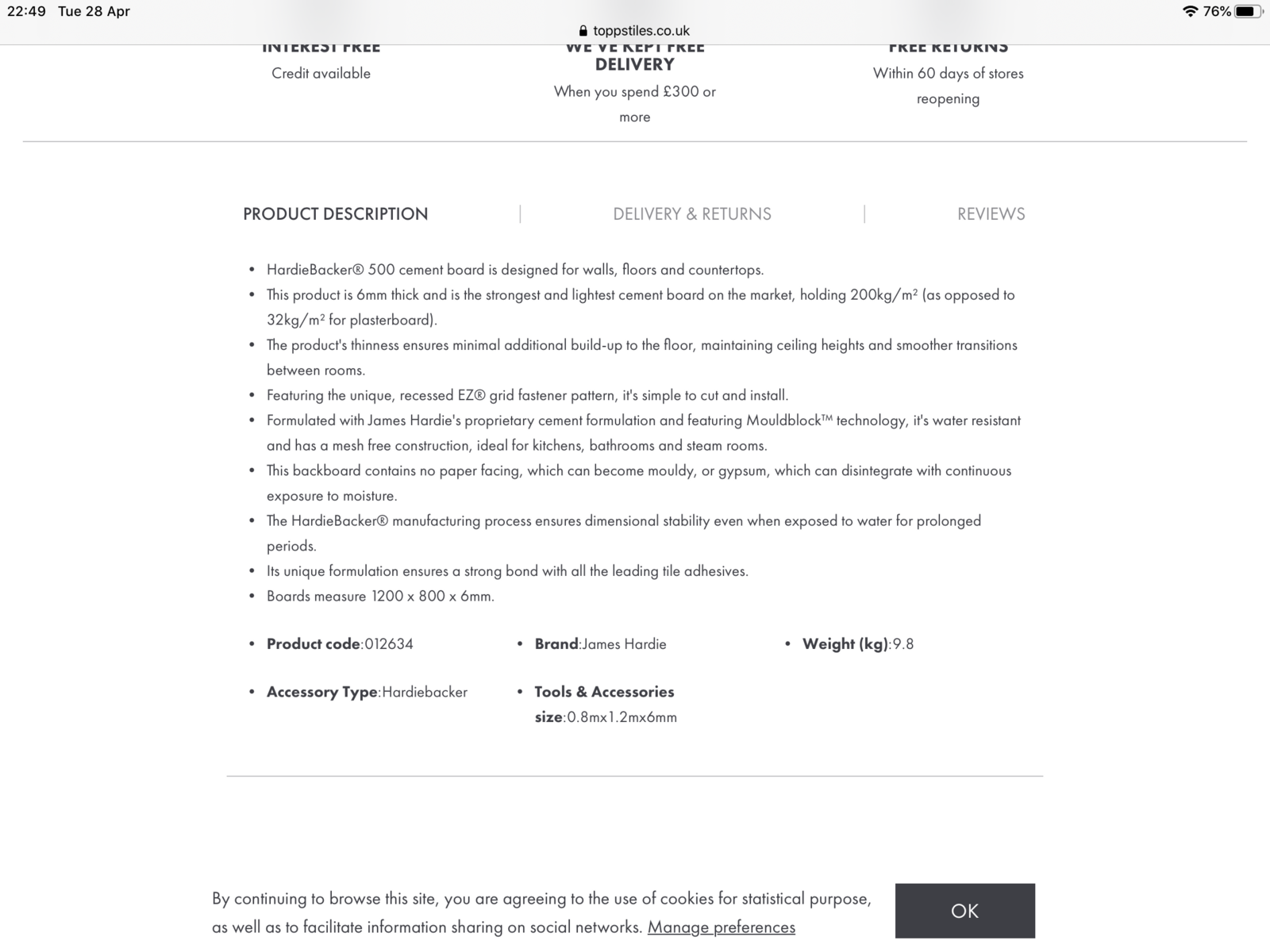

If I understand you want to use a cement board to then tile a bbq area.
I've used aquapanels to a kids shed roof tiled with leftover tiles which they then decorated. Still there after 10 years.
Just make sure you use exterior tile adhesive and grout.
Apologies if your project is not what i thought.
Look for a calcium silicate product (ed Supalux, Masterboard) but expensive.
Or a more common and cheaper magnesium oxide product ( ed Econic Board, Dragon Board) or lots of similar ones mainly from China.
