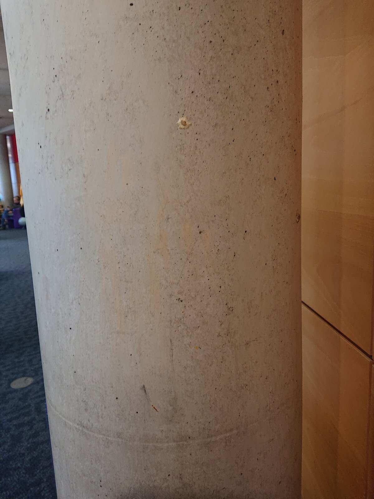

What mix do you need for precast finish, like this:
I'm looking for a smooth look much like you find on a lot of buildings and civil projects these days.
More important than the mix is using the correct shuttering and sufficient vibrio compaction to remove any air pockets.
