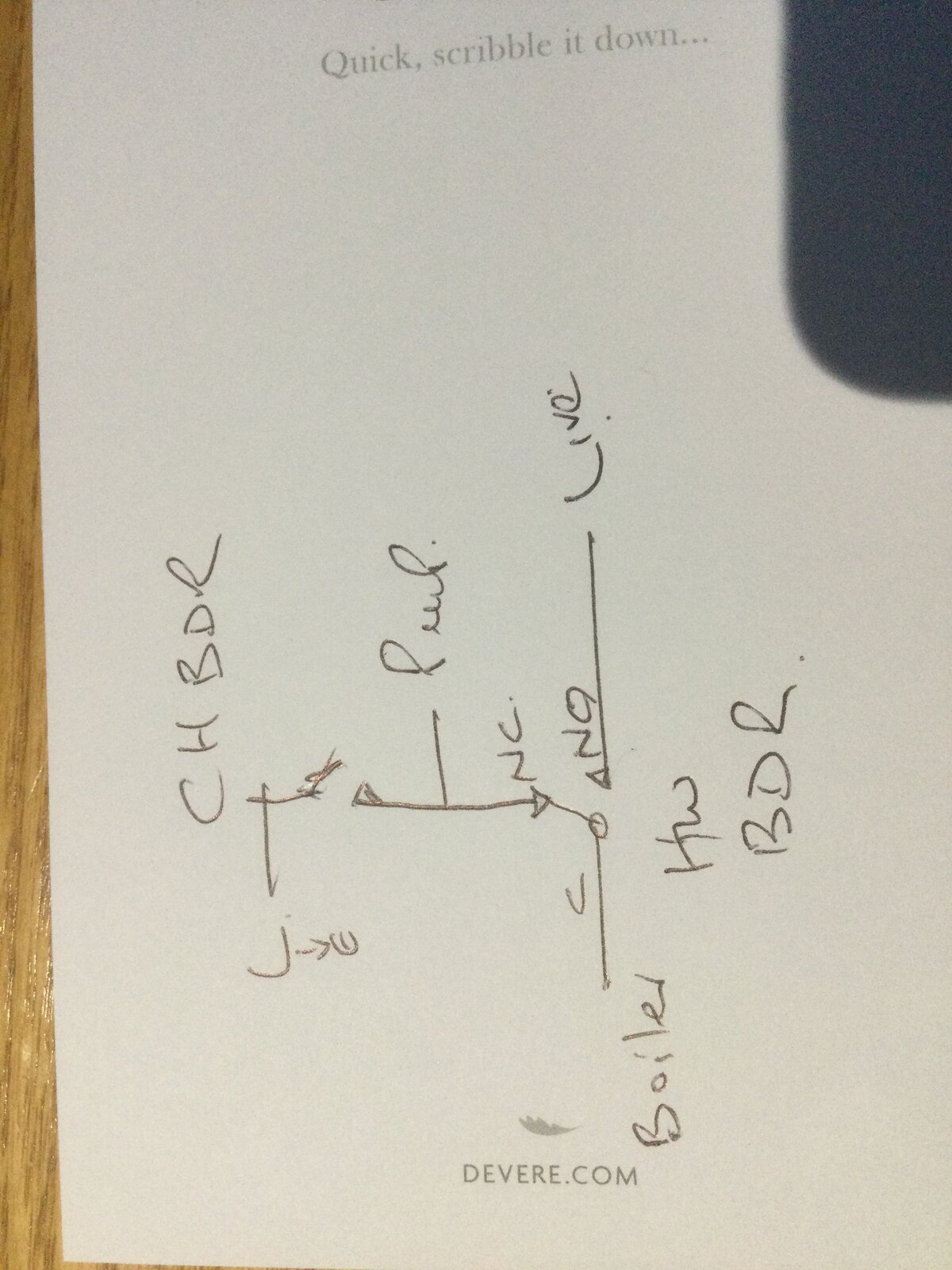

The drawing will give you hot water only or CH with HW

You will have 2 BDR wireless relays.
not having a motorised valve does not mean Evohome will not work.
your hot water BDR, connect A to boiler, B to Live and C to pump if pump does not run for hot water or motorised valve that stops circulation to rads during summer ( if pump runs)- call this point B
CH BDR
L to A
B to point B above.
Bobs your auntie :cool:
