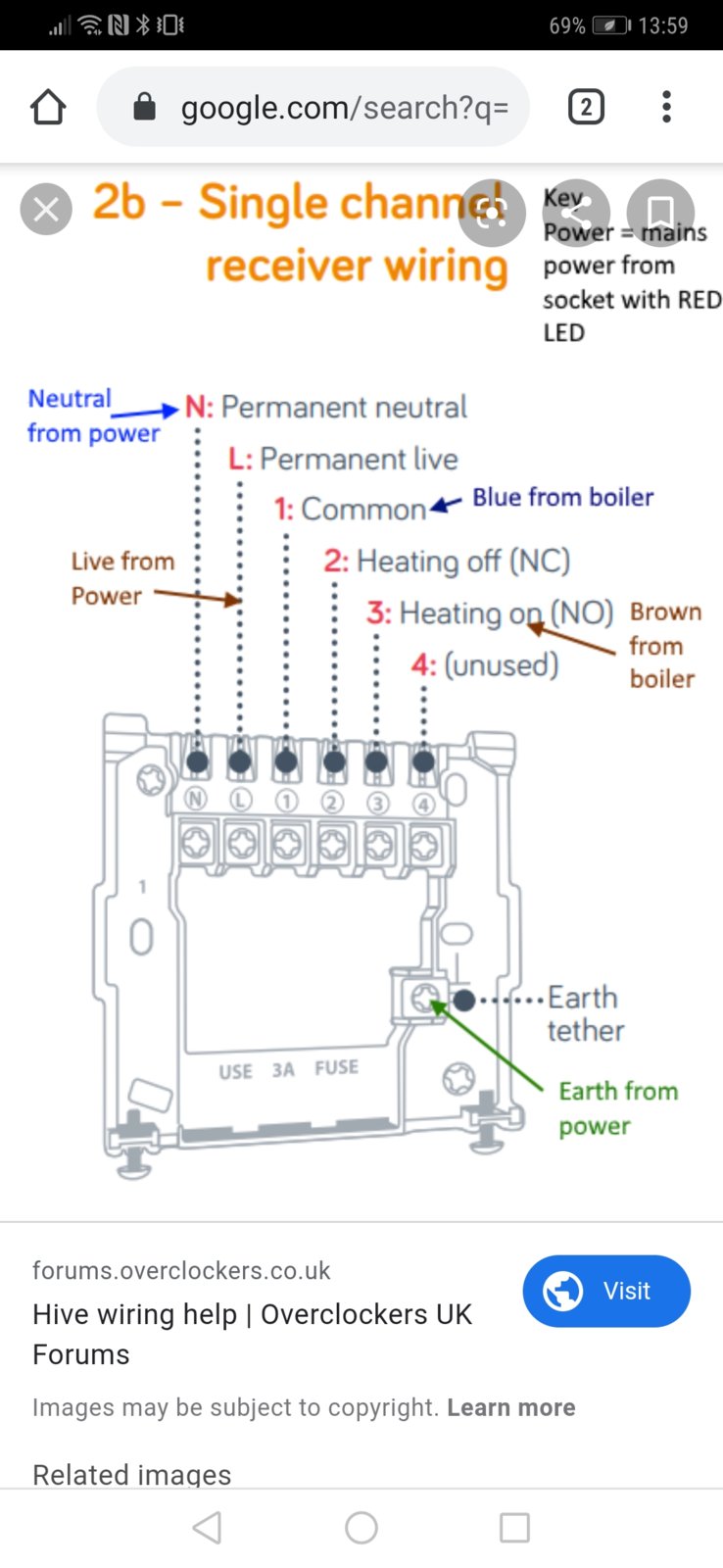

I am wanting to replace my centaurplus c17 thermostat with the new hive single channel. The wiring is as in attached picture. Is there any advice on how the wires should be moved to fit hive single channel receiver? View media item 103572

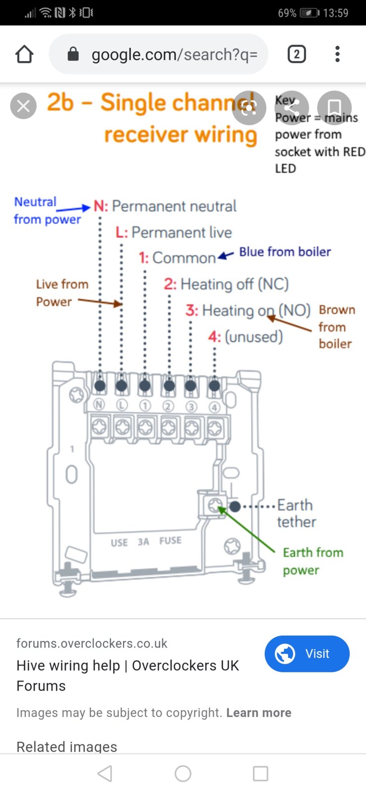

Apologies. The current wiring pic should be in my original message. The wiring needed is in the thumbnail. Screenshot_20191124_135948_com.android.chrome.jpg
you are showing wiring colours which mean absolutely nothing in a heating system, you will have to tell use what the brown and blue that you have posted are connected to at the boiler, they are probably correct but without knowing what is at the other end we cant really tell
